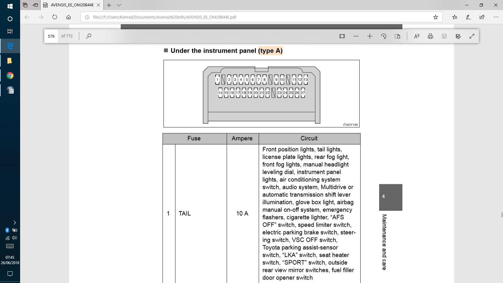

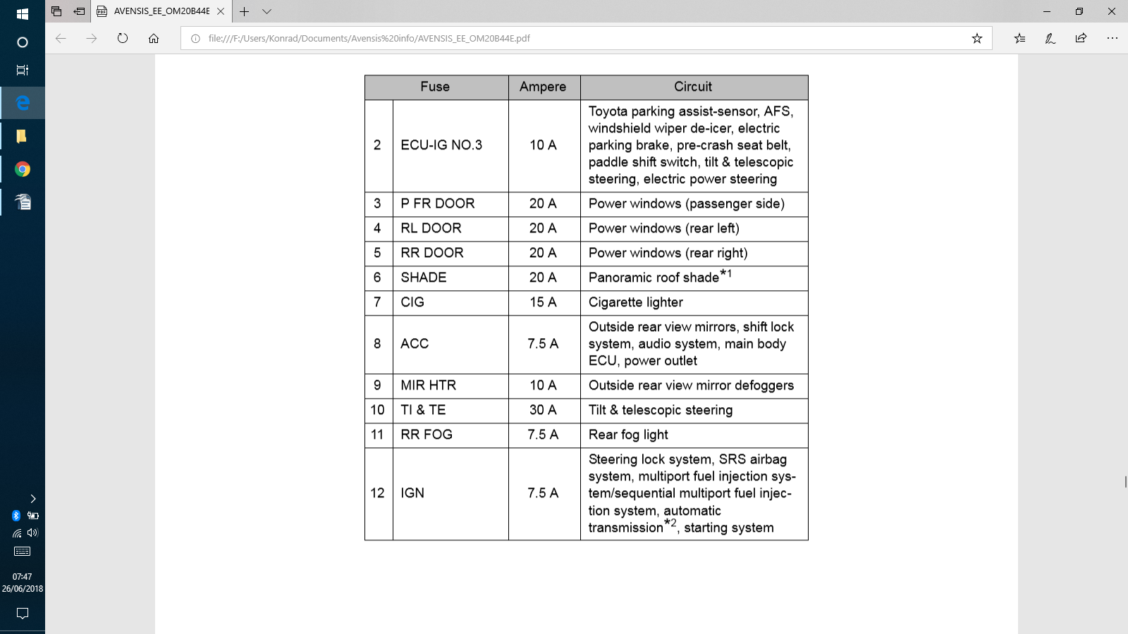

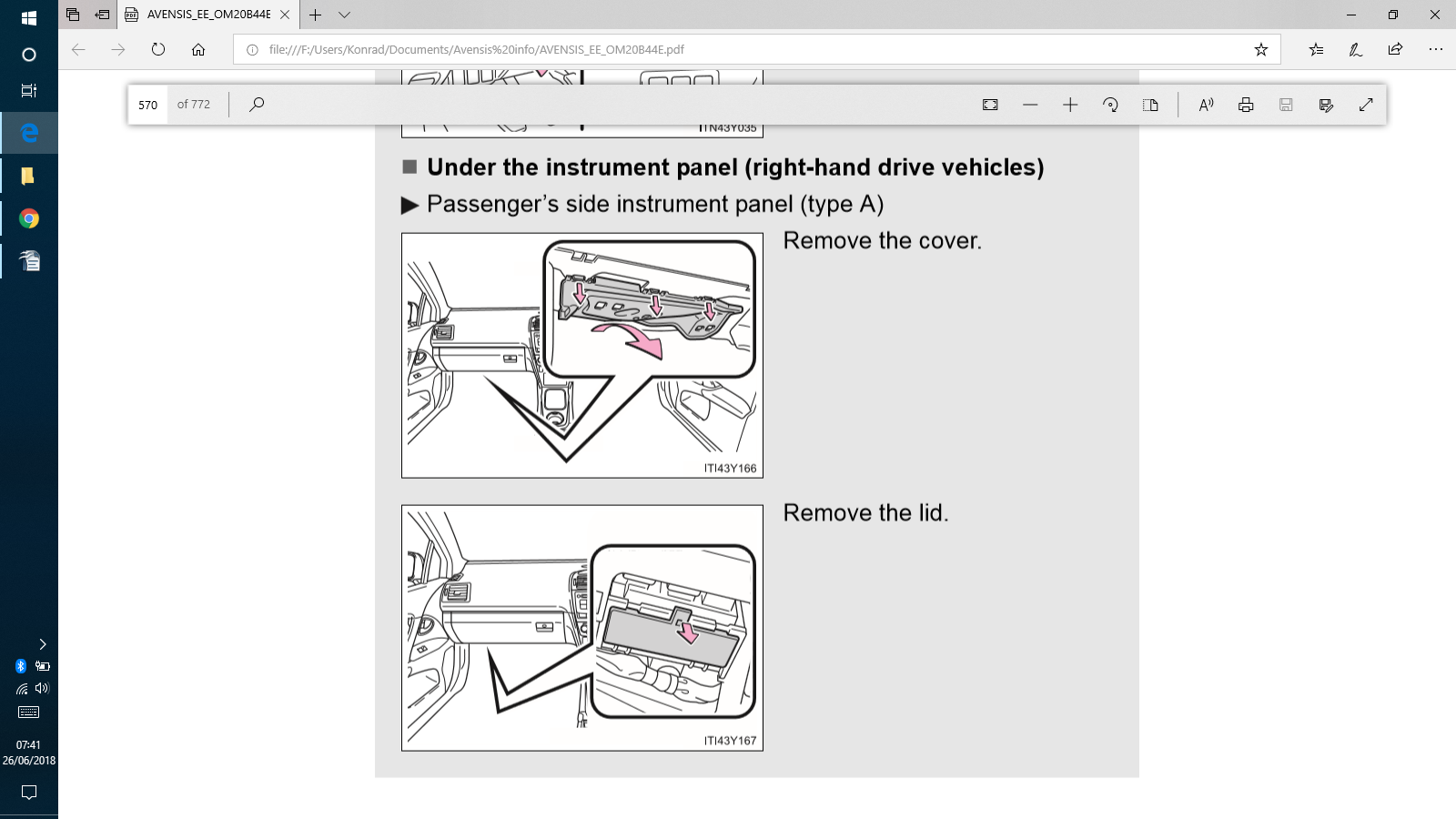

Hi Sam once again. The fuse box is located under the passenger footwell behind the storage box. The attached should help.
The fuse box location is further back in the footwell, behind the storage box.
The early fuse location differs slightly in number, but is the same position (fuse no.7)
