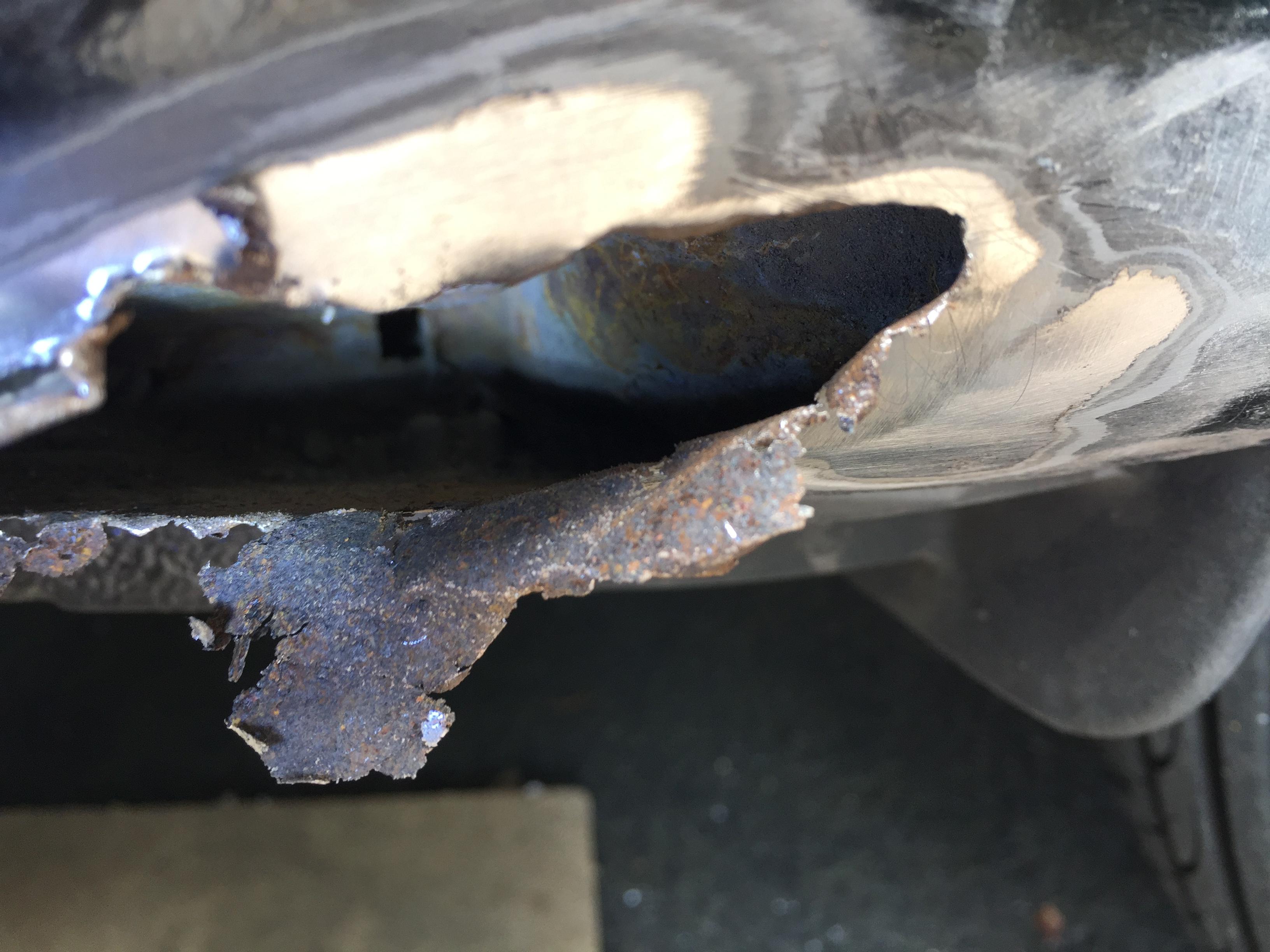

Hi All
What looked like surface rust on the outside (sill in front of the rear wheel) ended up in a hole where the sill had clearly rusted from the inside. Also found a small amount of mud (dried up in the hot weather). I checked the other side and this is still solid although when I removed the rubber bung on the sill and stuck my finger in the cavity I could feel dried up mud in there as well.
There clearly appears to be water and dirt ingress into the cavity but I cannot for the life of me figure where this is coming from.  I have checked the rear wheel arches and all looks good.
Any ideas on how this can be happening and also whats the best corrosion treatment?
Thanks

On the Auris there are two plastic oblong plugs or bungs that seem to be a dealer fitment when the car is delivered (PDI inspection). I found mine in the glovebox and fortunately the bag they were in had a diagram or instructions (its 8yrs ago now) of where they locate. As far as I remember they were on the rear sill somewhere. They just push and clip into place sealing the hole which was around 1.5 inches long I guess.

can you fibre glass a sill on an aygo ,i'm asking incase the sill is a structual part of the car
if it is, it should have a welded repair to maintain the strength of the car.
Putting filler of any sort in a sill on a Aygo is a mot failure.It will be near suspension or seat belt mounting so must be a welded repair i am afraid.
