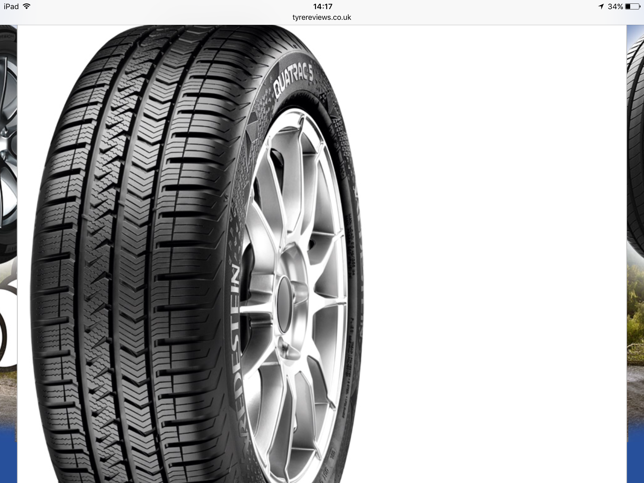

Guys, you can try an all season tyres that are as good or better than winter tyres and very good in summer too. The make and model is Vredestein Quatrac 5 , they cover various sizes so no worries here,  good reviews too. I definitely getting one of those at the end of the year.
