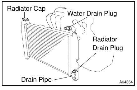

Anyone know if there are two coolant drain plugs on the 2litre D-4D engine(2004), as it says in the haynes about the rear of the engine block drain plug
would be great if anyone knows as it would save me a lot of hunting about when i get her up on the ramps in a bit

Not sure if your Verso Diesel is the same, but you have the drain plug on the bottom of the rad and there may be a drain tap on the rear of the engine block just above the exhaust manifold, so you get to it from the top of the engine bay.
Use a  mirror to help locate it first as its well hidden and perhaps give it a spray of penny fluid as it will probably not have been touched since it left  the factory and perhaps turn it carefully as it will be difficult to replace if damaged.
Its there to  help drain the engine block, but if you are changing the coolant its worthwhile giving it one or two flushes with water to remove all the old stuff.
