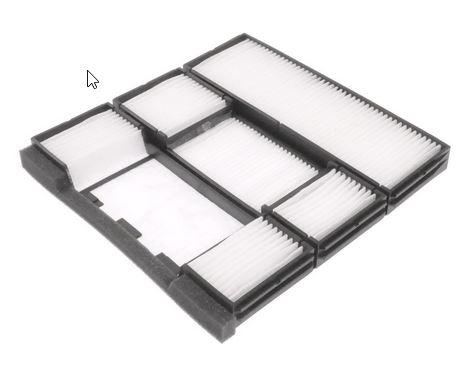

Does yours look like this ..?
Would have thought it must be clear how it refits as surely that shape will match the area it slides in to ..?
Again would have thought the area with the Top or the air direction Arrow markings would be on the front on the unit facing you ?
yes that is. no i know that the piece that has the notch takeing out of the middle there goes in first but i dont know should it be say facing the left or right if your understand me?

The foam end goes towards to the back end so you push it in to compress the grey foam end. Hope that makes sense.
