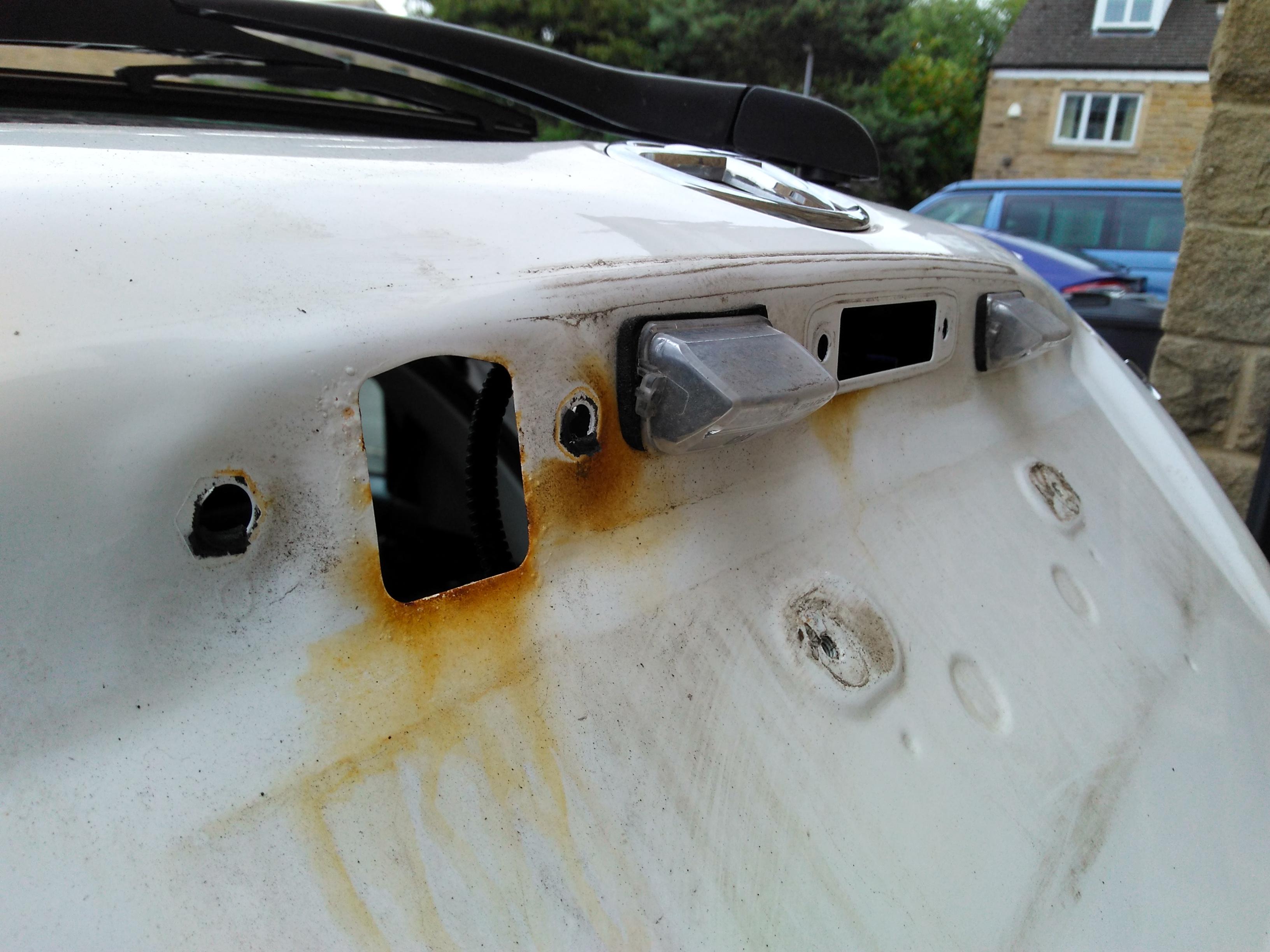

This is my 2013 Yaris not good.i bought car at 3 yrs old and spotted a few weeks later rust stain on tailgate took back to Toyota they repainted the tailgate.2 yrs and 2 months later rust was back but worse this time out of warranty had to ring Toyota customer services about 12 times 3 months later they finally answered my question they would pay half of cost of repair totally useless  they bodged the paint job then as soon as it's out of warranty it's see you later to rust at 3 years old then come back 2 years later is totally unacceptable poor quality Toyota won't buy another 😥

My tailgate also has rust problems. The paintwork here is inferior to my 18 year old Vauxhall and is more like my 38 year old British Leyland car. On the Vauxhall, if there is a breach in the paintwork, rust will not spread under the good paint. On the Yaris, you can see the tendrils of rust spreading out under good paint - shocking in this day and age.
You can see tendrils on the first of Terence77's photos.

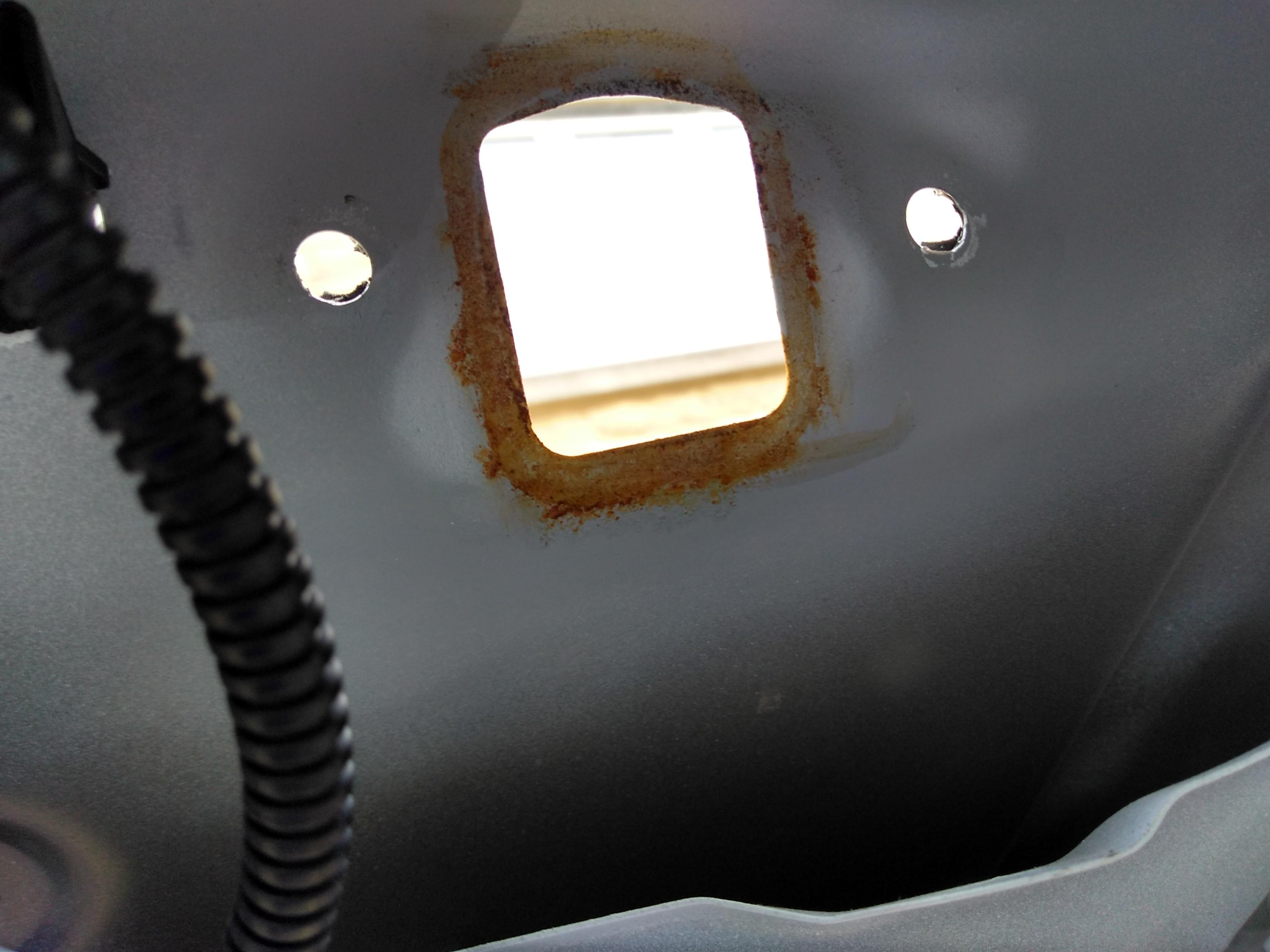

mine is not as bad as yours but i do have some just araound the camera hole, the bottom of which i wiped off and repainted and the ones inside i sprayed with a thick layer of white lithium grease, im certainly not taking it to toyota if this is the shoddy job they do, they cant even be bothered replacing a fully coroded bottom hose clamp and they didnt want to replace my timing chain with a loud rattle either until i pushed it through, i think french built cars are really sub standard, my uk built honda jazz was rust free everywhere when i sold it at 6 years old so i will be taking my business away from toyota for my next car

Hi I'm not going to paint it over i t cutted it and used touch up pen going to get shut of it.ps had three Corsa,s before the Yaris kept one for six years amazingly none had any rust I think Toyota should cover this fault I suspect it's the foam gasket round the camera although that doesn't explain rust on other side never mind bring on new corsa.
i think it is a design fault as the gasket is on the inside and not the outside like the number plate lights and the boot handle so road debris and salt etc can get in behind the lip of the metal and start to eat away the edge as when you wash the car you cant get much water in there because of the camera in the way so it never gets fully clean, i wonder if they redesigned the boot camera hole in the latest facelift yaris to get rid of this problem

That is really terrible! I'd be gutted if that was mine. I once had a similar problem on my Corolla gti, the tailgate started rusting around the rear screen and rear wiper aperture when it was about 3 years old, Mr T repaired it under warranty but it was soon back after a couple of years. I saw loads of the same model doing the same thing must have been a design fault. I can't believe they're making the same mistakes all over again.
You can see what is happening water is getting under the paint work around the edges where it is darker. And the rain is dragging the rust down.
its a poor design to have an open hole like that, it should have a cover over the hole on the outside like the number plate lights and the boot handle, the rain and dirt in the winter gets behind the edge and rusts from the back as it is hard to clean in that area (where there is a gasket around the back on the camera) but not flush to the edge of the metal , it needs totally re-designing it would be so easy to do, i havent checked the latest yaris to see if they still have the same design but i do hope they have it completely re-designed for the next yaris in a couple of years time
