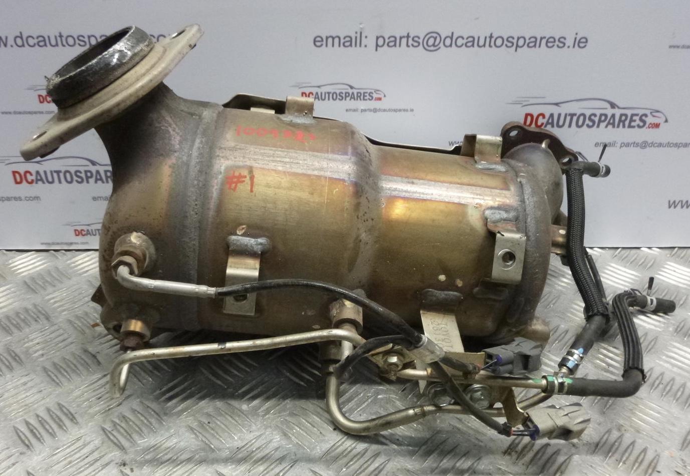

The picture shows basically what you need to remove. The exhaust connection is top left and you can just see the turbo connection top right. The two impulse lines have been disconnected at the flexible pipes and you can see the connector blocks for the two temperature sensors.

For anyone else looking at this and wanting part numbers, it says
Bm Catalysts
Referencia del fabricante BM11060H
Referencia OEM 25051-26020
It seems the part number is the same whether I buy it on Amazon UK or Amazon ES (Spain), so I'll assume there is no difference in LHD/RHD.
