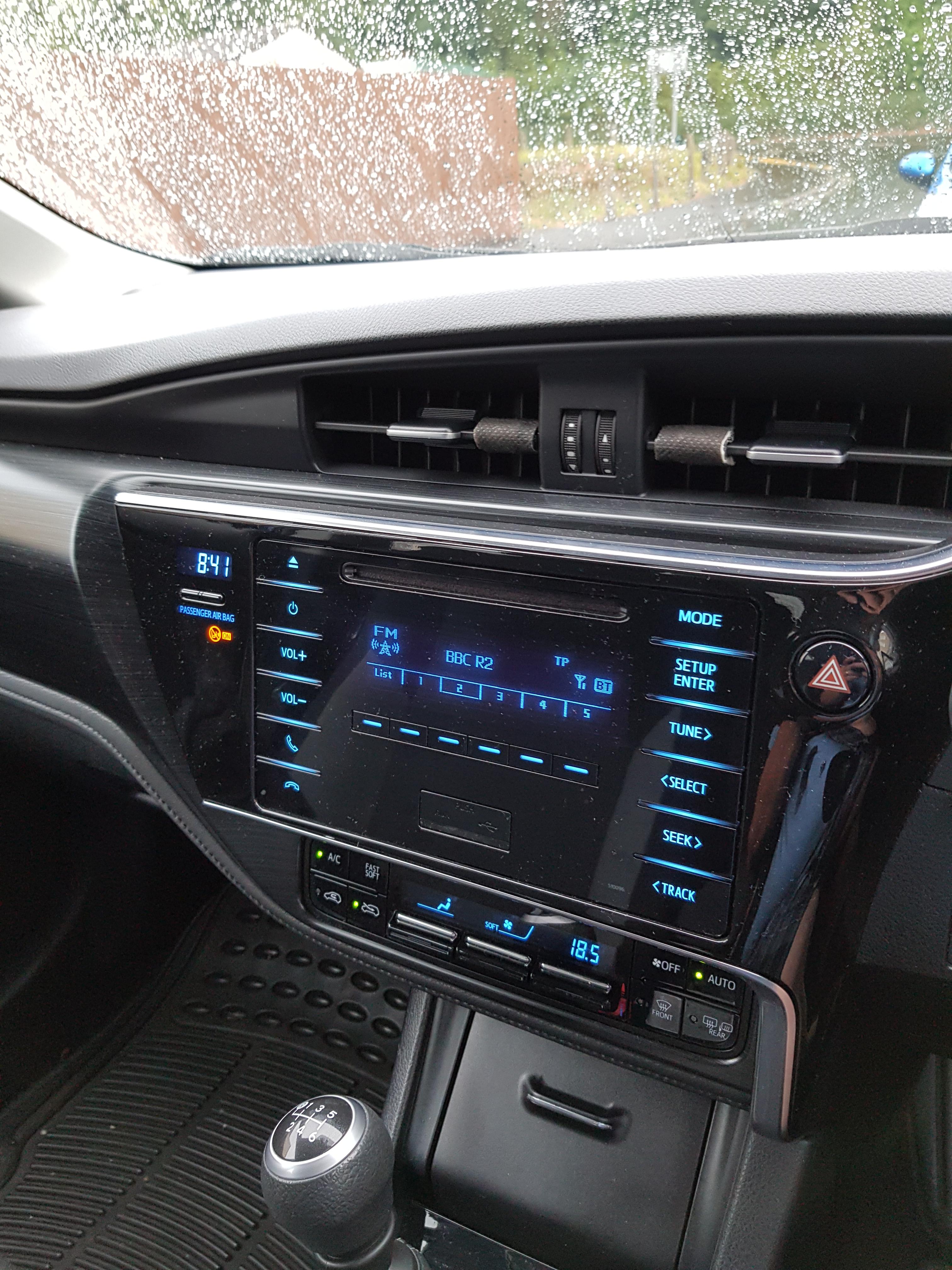

On the same sort of theme , is there anyway to turn the brightness up on the radio of a 2015 facelift Auris active ?
It's usually linked to the dashboard illumination level

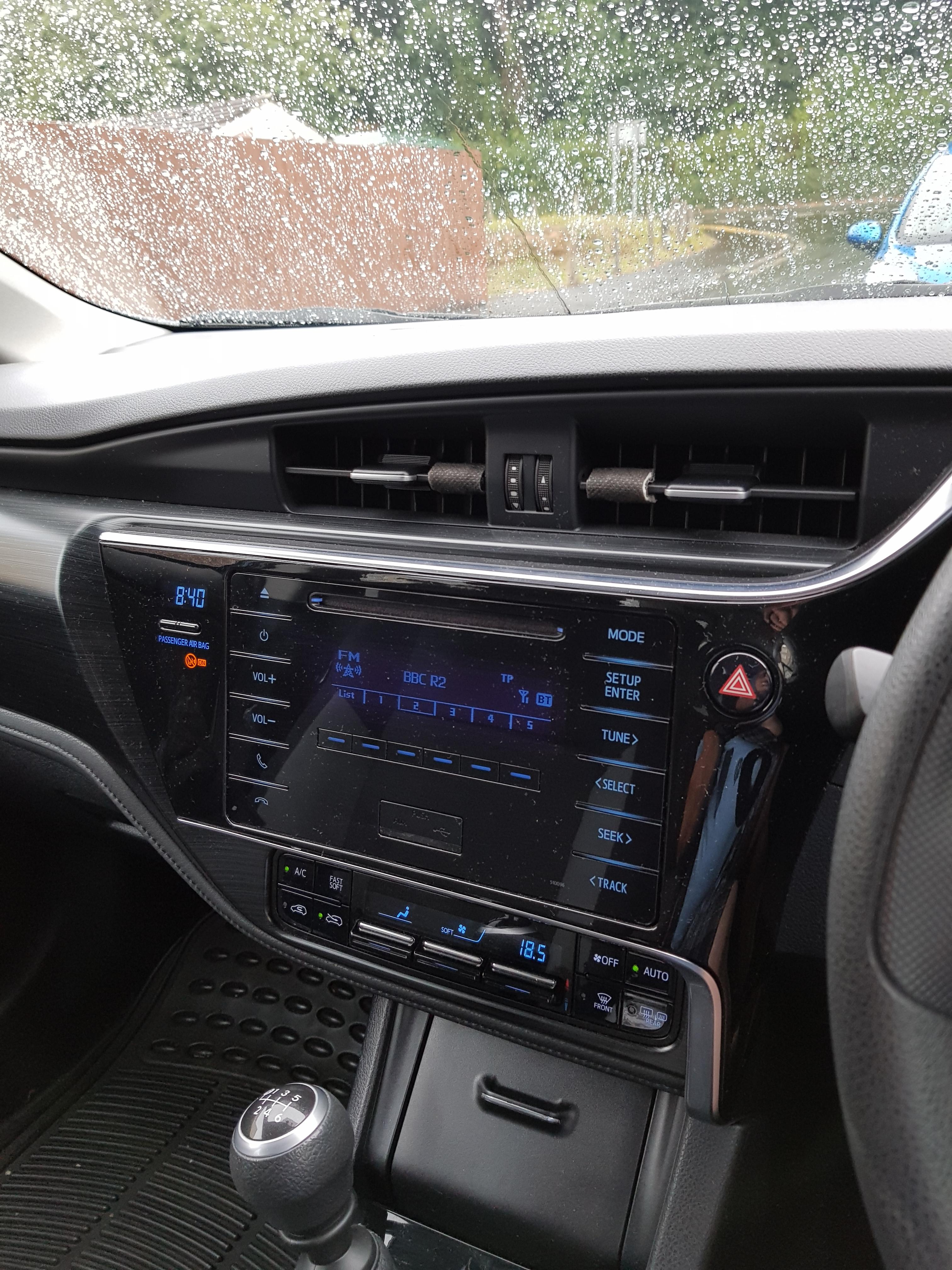

Scott , i thought that as well as that was how my Mk1 auris worked . As sson as i switched the lights on it dims to the second photo . it is fine at night but if driving in  the day with dipped headlights on you can struggle to see the radio
That is it working as designed - when you switch your lights on the dash, & therefore the head unit screen, dim to whatever level (user adjustable) you have set for night.
I am not familiar with that head unit but you possibly may be able to over-ride that ( there may be auto, day & night settings as in this & my last Avensis) but then you can end up with a head unit screen that is distractingly bright at night.
Agree that it is working as designed but with it being flat screen it really suffers with glare . I have looked in all the settings and it appears there is no option to alter the radio face..
