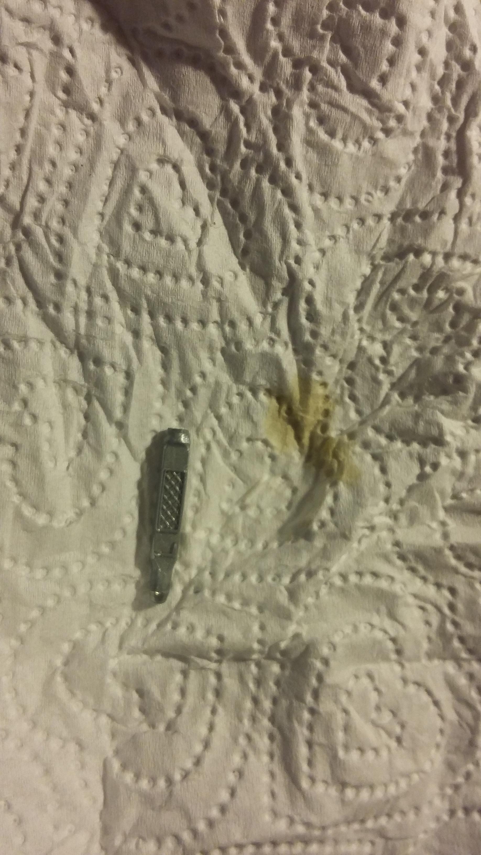

I attach a picture of the broken end.20180806_225558.thumb.jpg.1edd70fd30571e6aeff86205f895f592.jpg
At least you've been lucky it didn't break off inside the engine 😨
Is it the braided wire that has broken or just the cast metal?
My dipstick is made from a braided wire and this seems to run right to the end of the cast metal bits making it fairly robust. Just wondering if the wire stopped short of the end on your one?
Craig.
I think it is the cast metal that broke. There is no sign of cable in the broken bit. The cable only protruded about 1mm from the other cast metal bit. When I get my new one I will post a side by side photo of the new one and two bits of the old one.

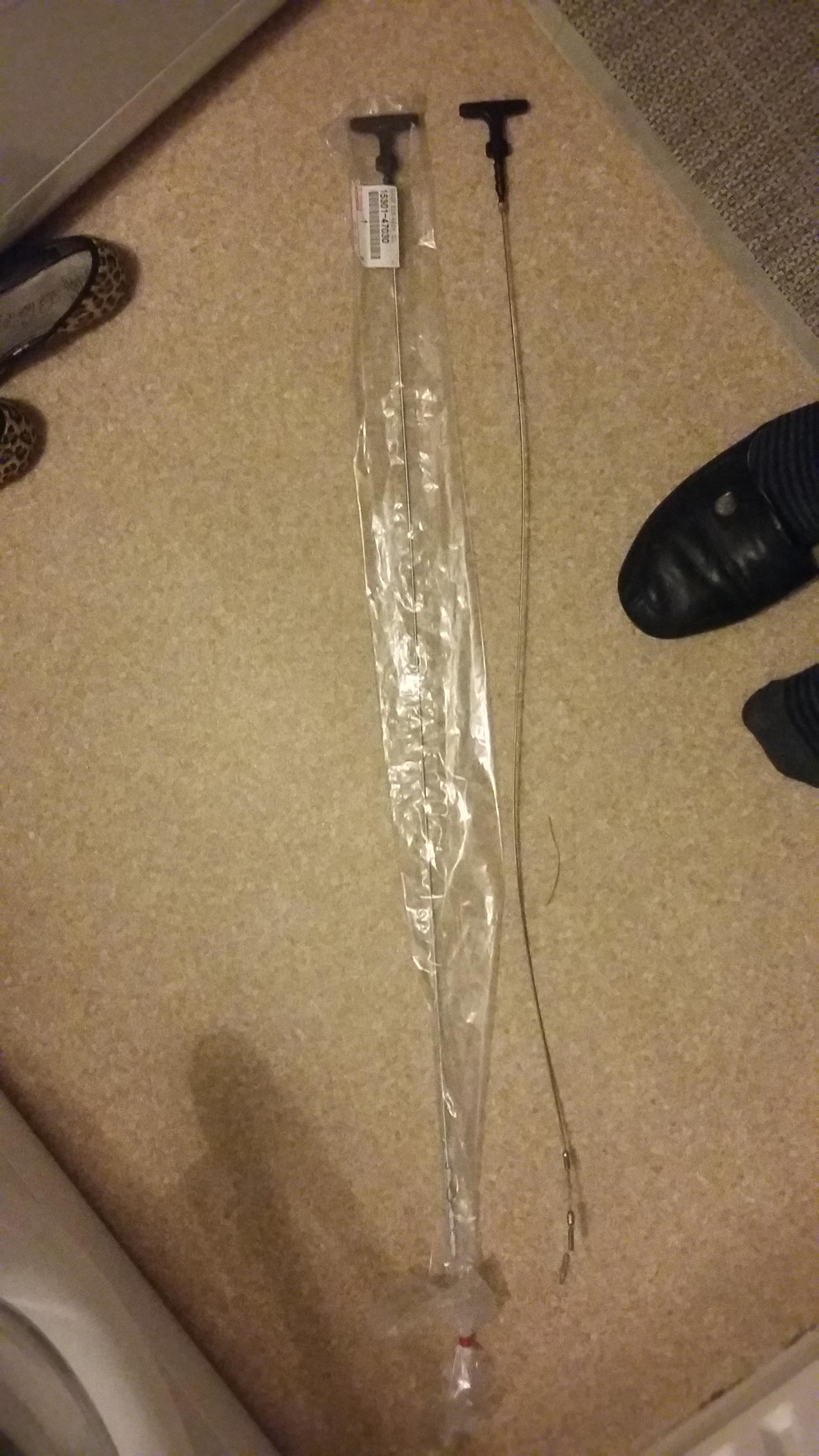

I got my new dipstick today. I laid it out in the utility room with its broken counterpart beside it. I could see the problem. The broken one was about halfway between full and low longer than the new one. 377 wipes downwards with a paper towel had made it longer and then the end, no longer with a wire inside it, broke off! I attach a photo. I shall be a lot more careful wiping the new one! Fortunately I had topped up the oil relatively recently from halfway between full and low (actually low) to full (actually halfway between full and low) and so I do not think it had ever been below the real low mark. I will top it up properly again soon (engine warm, on a flat surface and having waited five minutes with the engine off).
I checked the oil level properly today with the new dipstick in. It was half way between low and full as I suspected it might be. I topped it up to full. I am now thinking about the best way of making sure the same thing does not happen in another seven years. It may be possible to just measure the length of it and check from time to time. However it is such a long wobbly thing this may not be as easy as you might think.

Yes it is not a very good photograph. I should have shown just the ends of the two dipsticks. Then what happened would have been clearer.
