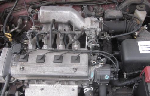

Hello friends, is there anyone who'll tell me where the maf sensor located on 4a-fe engine ? Searchin around to clean;  i've only found on vvt-i engine but could not find on mine.
Would be great if someone shares a photo of it😊
It should be on the hose that connects to the air filter. Just search for some wires on that location, should be it.
Okay then i will. Sensor on the filter box was air temperature, wasn't it ?

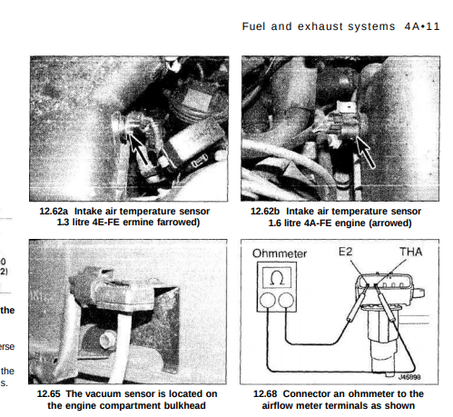

This should cover your 1999,   1.6L, 4a-fe engine, according to it there's a MAF sensor there, and an air temperature sensor, on page 97.
I suggest saving the file, as it's a good manual to fixing your car, in general.
http://toyota.aitnet.org/Toyota/Corolla/Corolla_E11_Haynes_Workshop_Manual.pdf

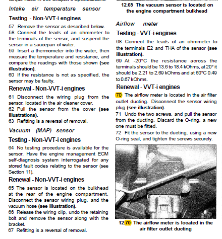

But it says renewing and testing on vvt-i engines, i guess mine does not have
