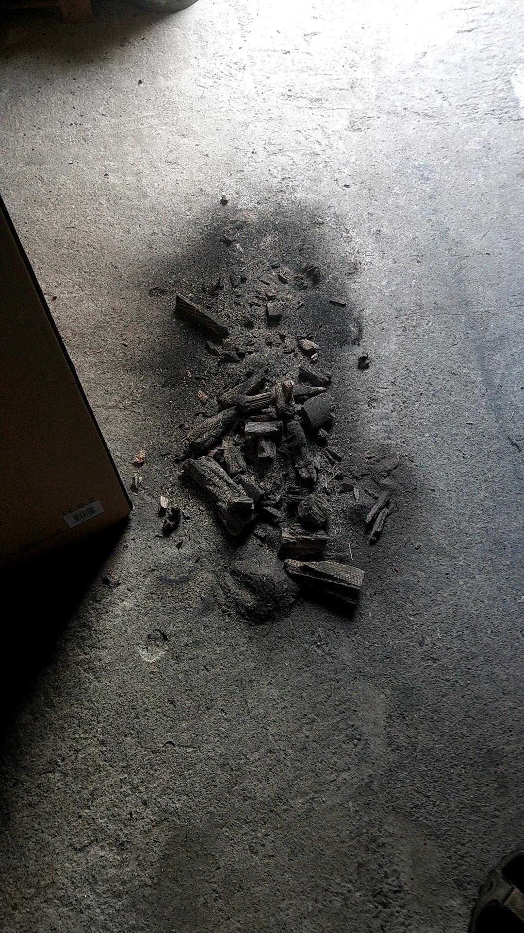

Thank for the tip. Just bought a 05 with the same issue, gone beat the hell out of the catalyst and see😜

You don't have to do long mileage, but you have to give it a Italian tuneup once in a while, 20-30 mph trip in higher rpm's.
