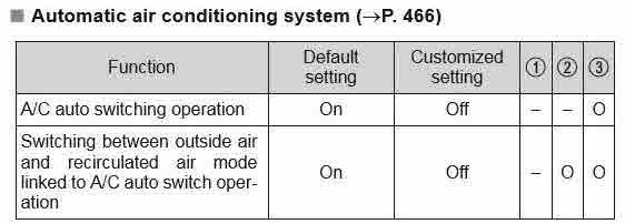

5 hours ago, PeteB said:
I'm pretty sure there's an option in the settings somewhere that allows you to cancel this behaviour (at least on the non plug-in, but I'd expect them both to be the same on this one) - when I've more time I'll try to find it.
This is what my non-plug-in manual says:
2 = Settings that can be changed using the navigation/multimedia system
3 = Settings that can be changed by any authorized Toyota dealer or repairer, or another duly qualified and equipped professional
I really need to get out more!

Thanks. I have tried those and they don't seem to affect the recirculation going off automatically. Amusingly, if you want further proof of Toyota's utterly random approach to car specifications, on the PHV the first of those two options is actually configurable on the Navigation unit!
