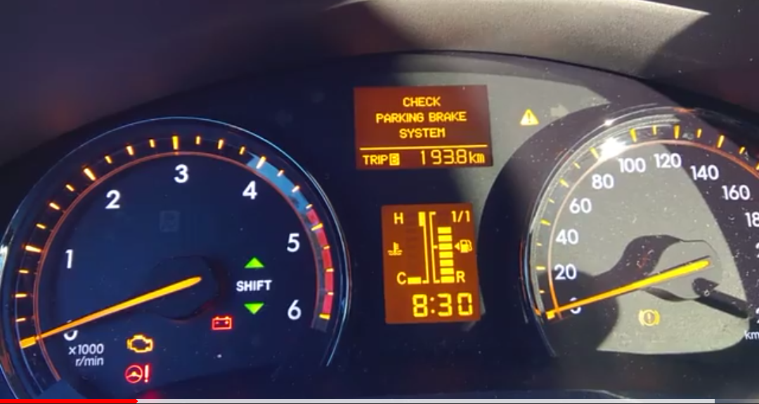

Hello,
I found this video on YouTube. It has the same problem.
It's about Toyota Avensis 2.0 Diesel (2013). The problem is not all the time. It happens often. I started to ignore it ... I made diagnostics. The result was (deviation of one of the injectors). Little wonder ... there is nothing difference in engine performance.
