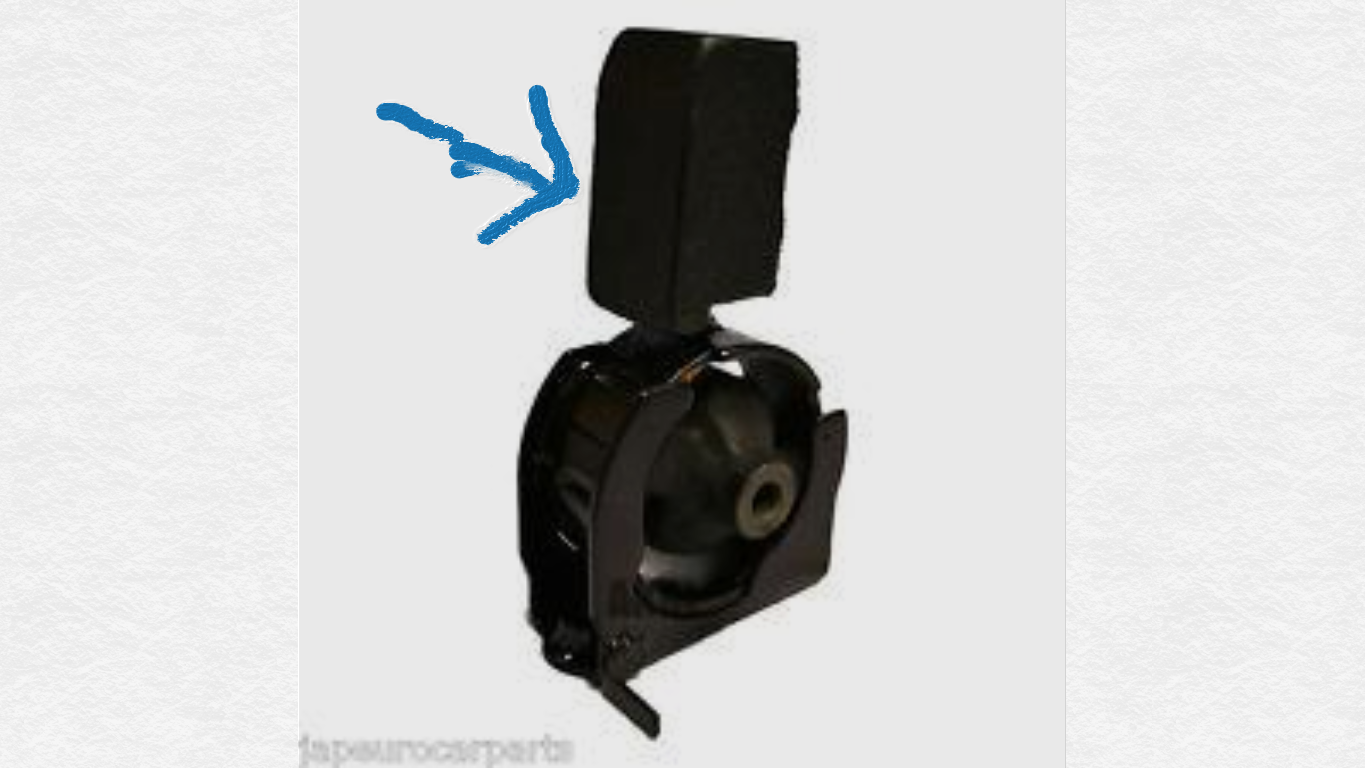

My mistake - Avensis T25 2007 D4D diesel 93KW - and i dont think that there was anithing on the mont ,it looked like this but the original had bigger hole and "stronger " rubber
One idea - I am not sure that we fitted the mount on the riht side.The artistic blue arow is pointing on the side closer to engine and i think that it shoul be mounted on the other side so that it can "work". Any ideas??

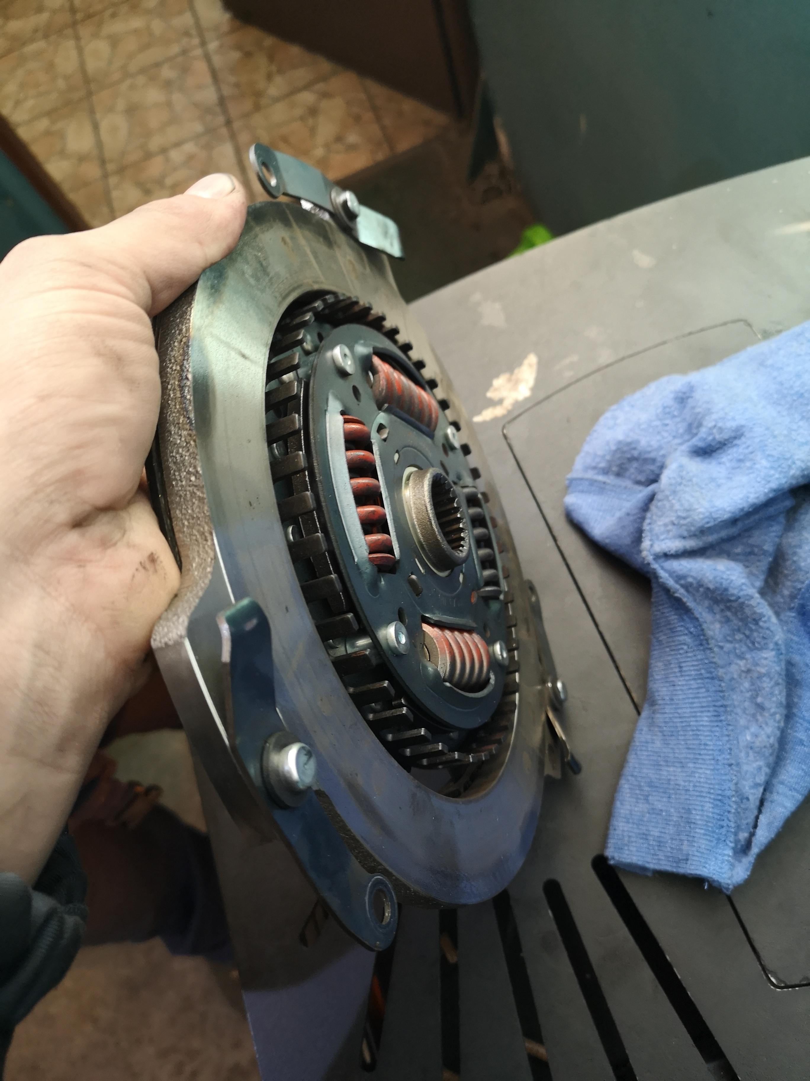

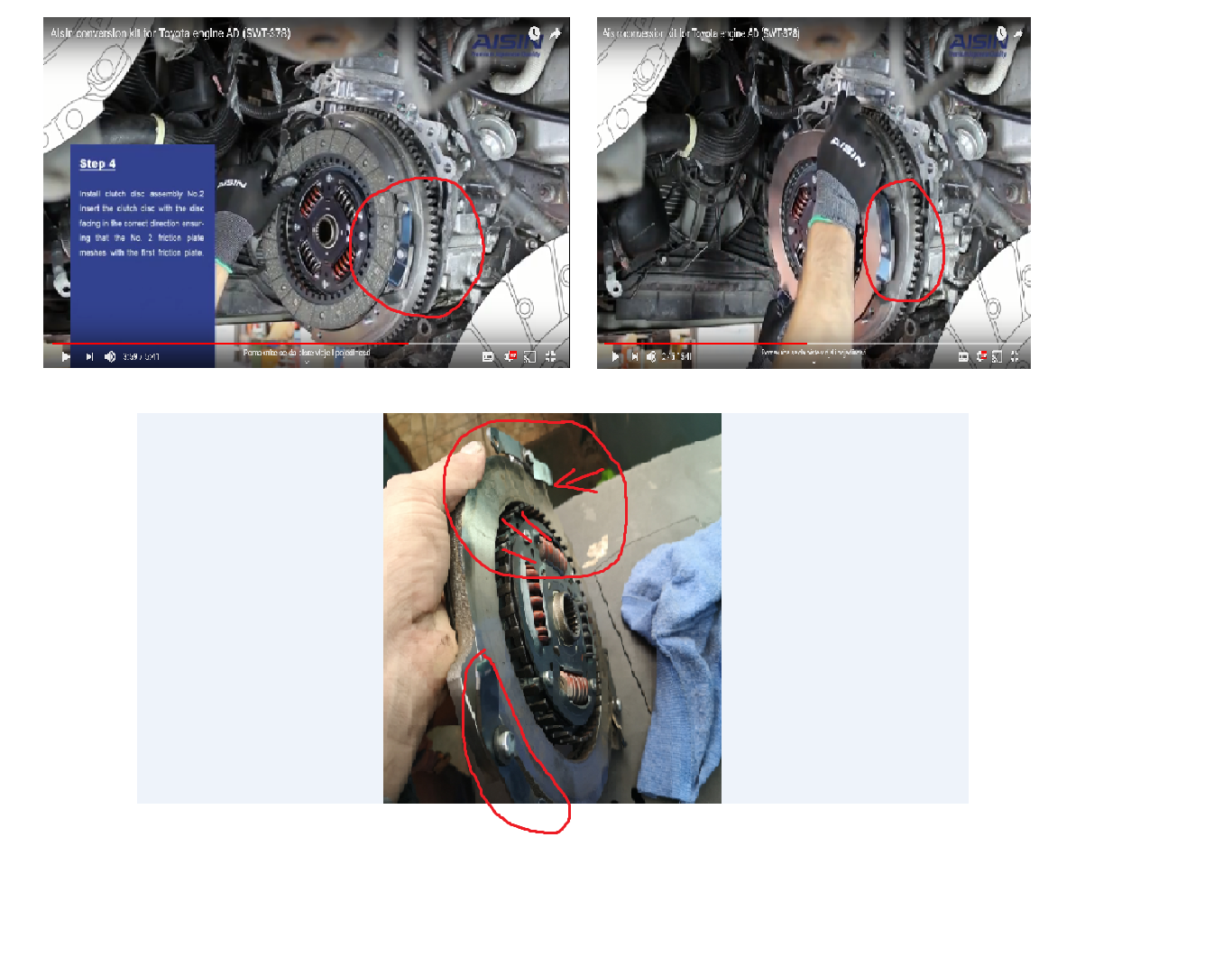

The vibrations solved - almoust zero now.Yesterday they took the cluth kit dow and mount it again and when the kit was down thej tooked some photos - you dont need to be the doctor and to see where is the problem - look on whitch side do the markings go on the midle presure plate on the photo and how do they supose to go!!

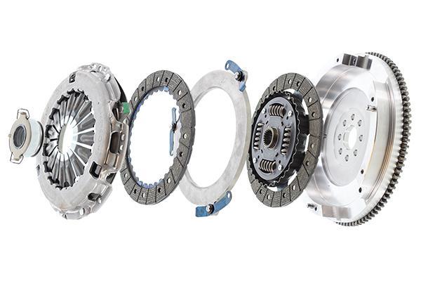

Problem was that they installed the part incorrectly. From the post it looks like the middle pressure plate was installed wrongly, that is why he put the picture of the correct parts in order.
From the post it looks like they just flipped the middle part around and it was fine.
