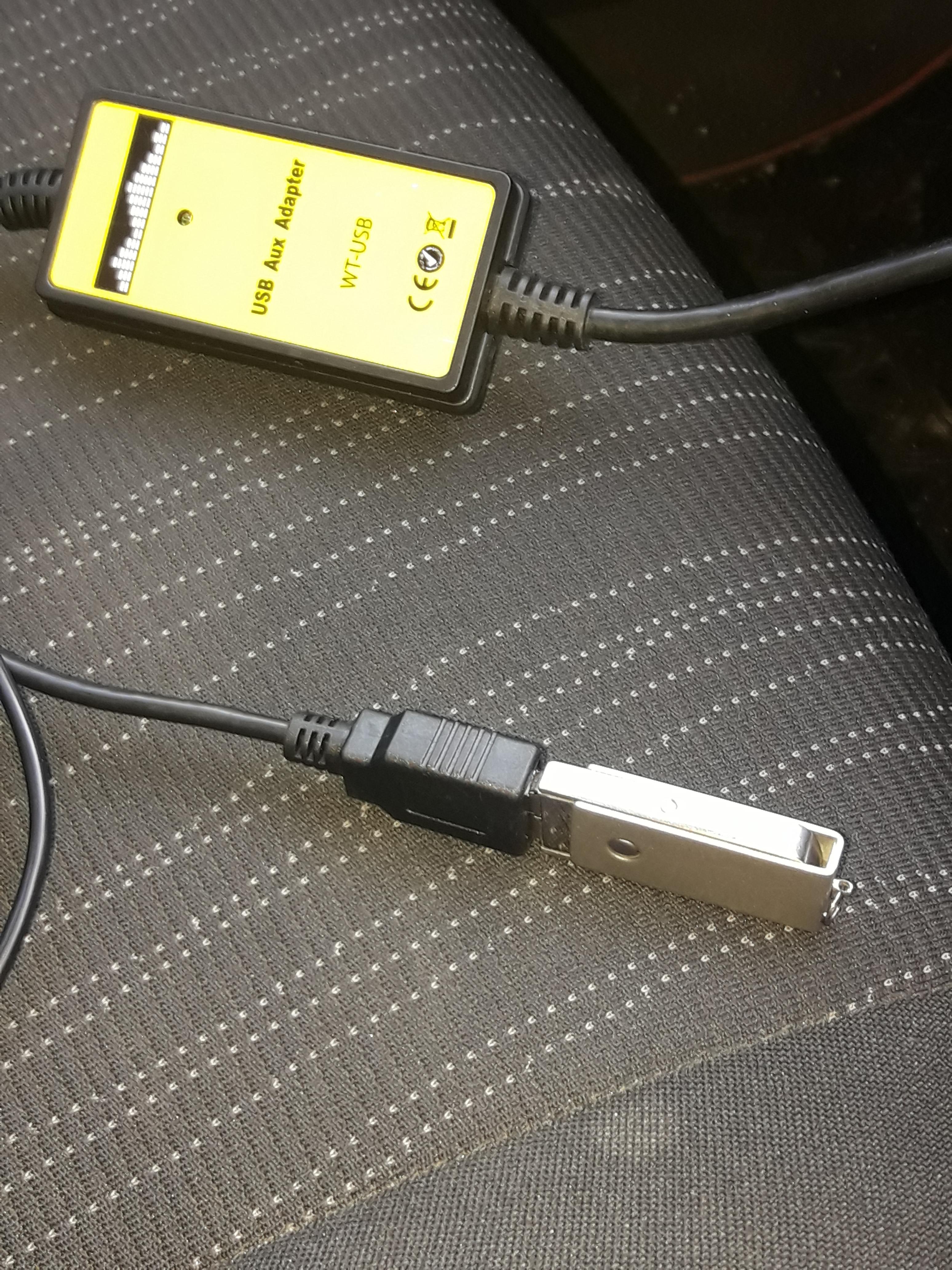

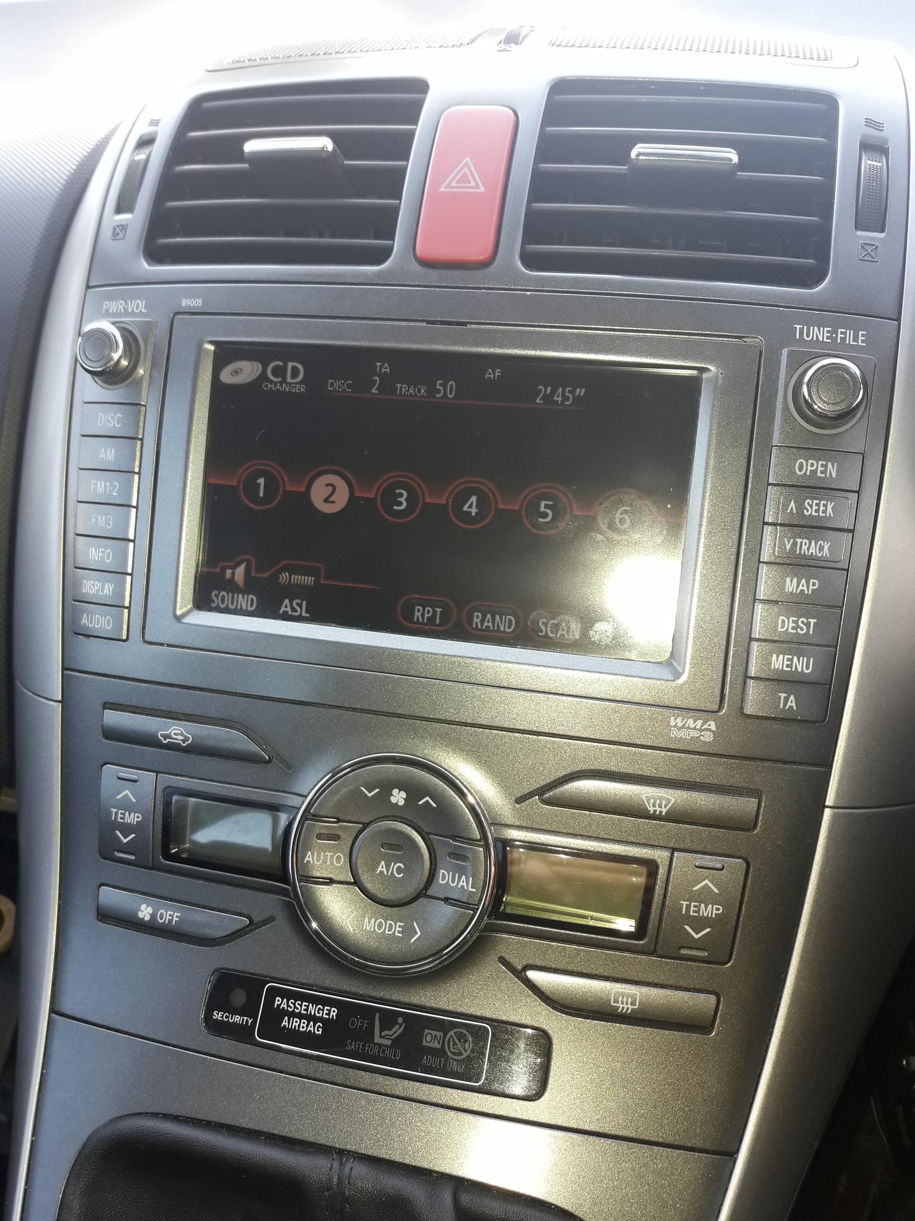

hi im new hew thats why idnt know how to make new topic.. so i bought a cable to connect to my touota auris 2008 sound system.,.were is cd changer place..and this cable have usb port..so i put the usb there and on the screen i have like cd changer 6 cds..but i can play only the first cd...i check on the internet and i follow everythink..i rename the folders cd01  cd02 cd03.....but still play only the first folder..cd01...when i pus the screen on number 2 or 3 or 4....nothing happen..just make one bib sound...in every folder i have 99 songs...can somebody help me what to do?for now i can see only cd 1 wih 99 songs...how to make it to play and the other music..cd2 cd 3......thank you..

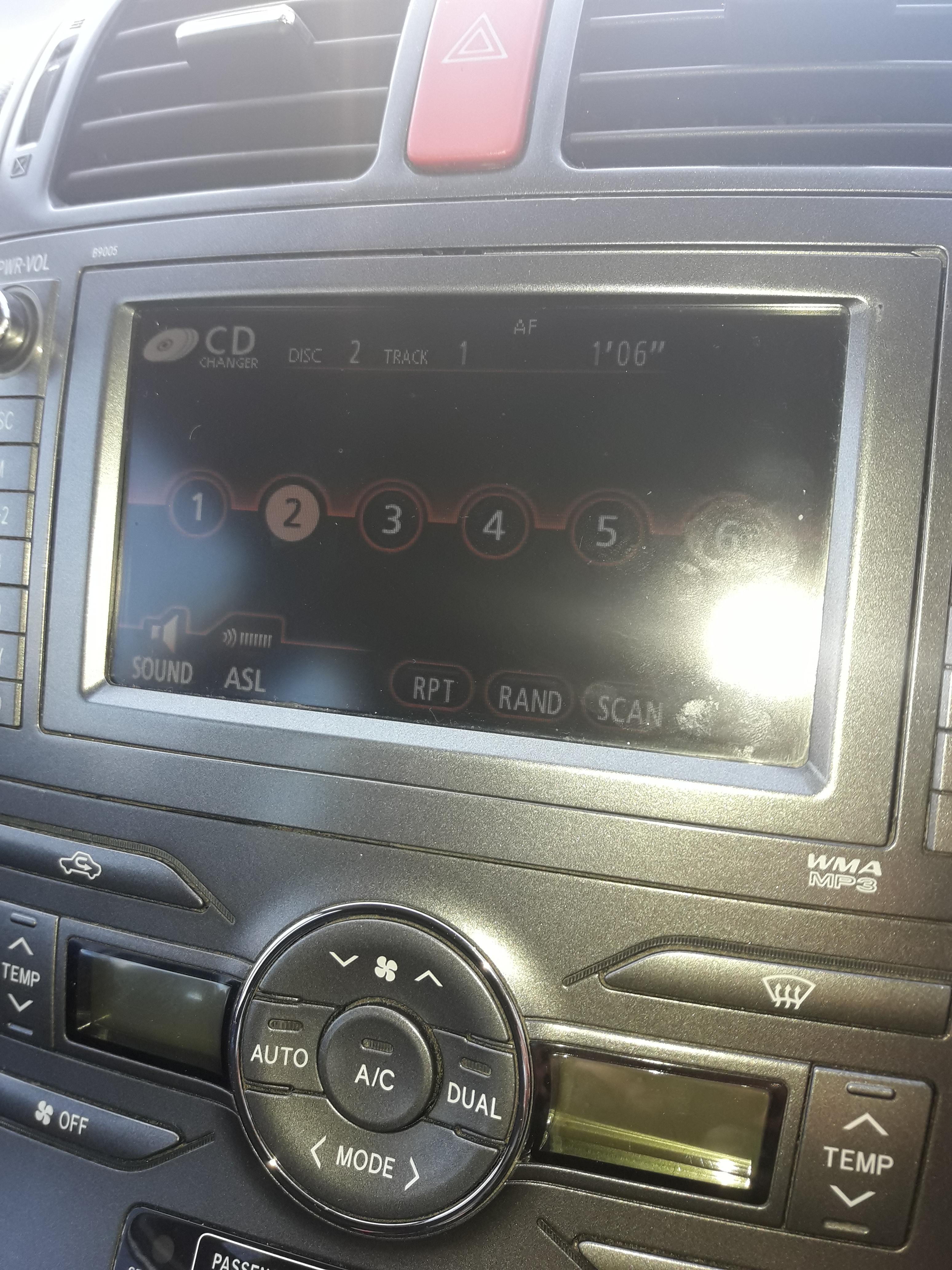

I can see 6 CDs but plays only one..at this time play only the number 2....and I cand change it....any help?Thanks

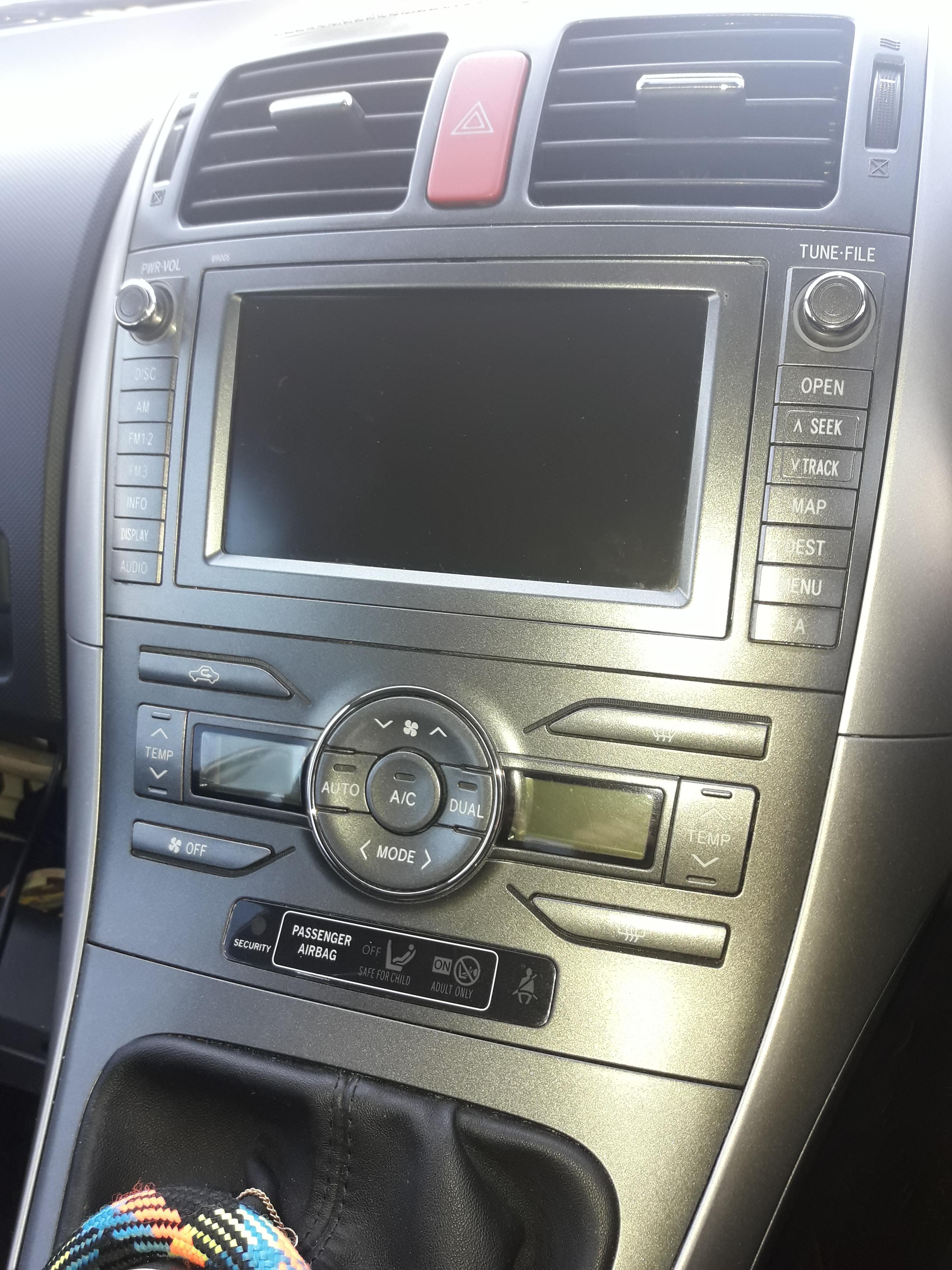

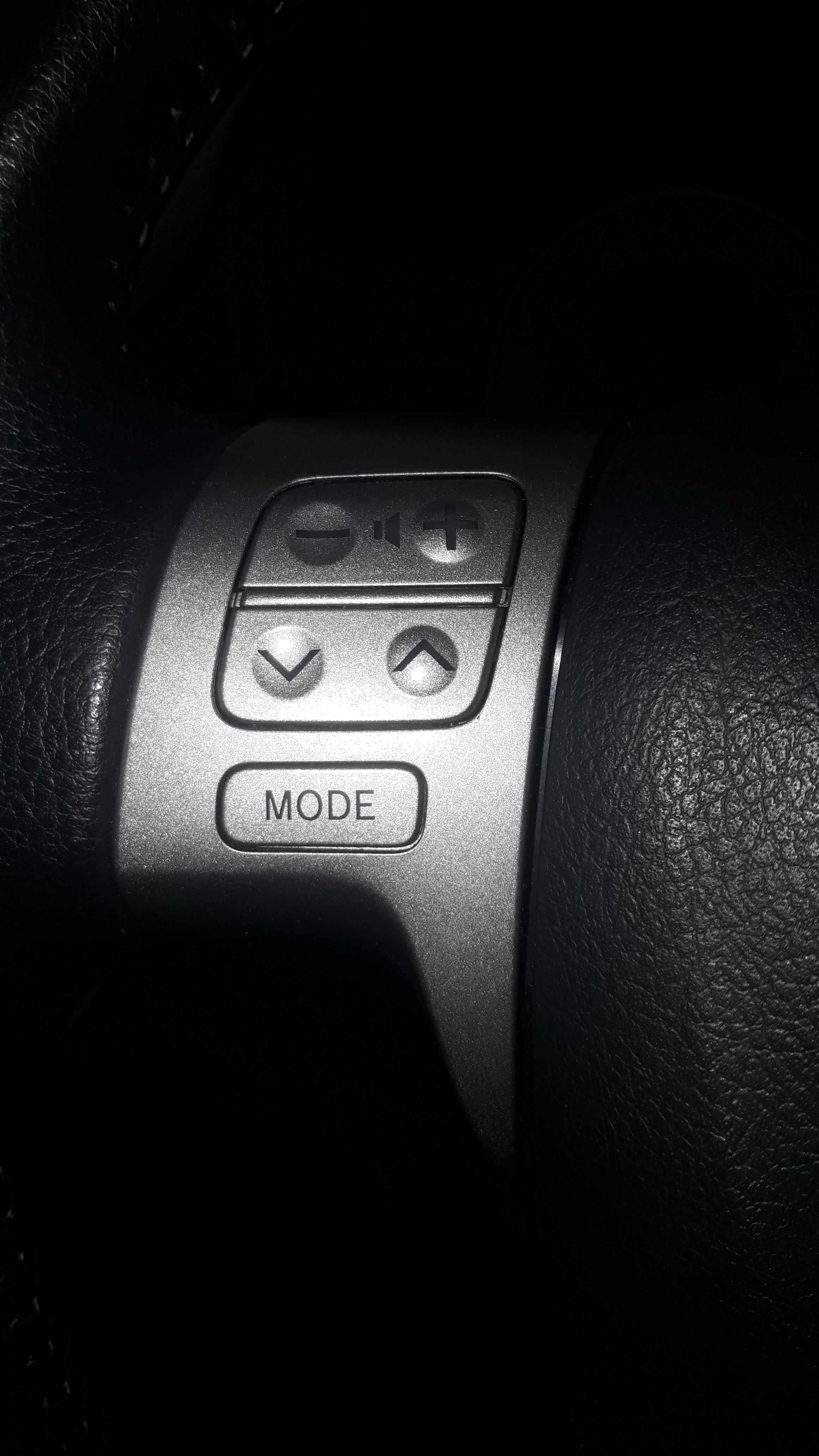

Hi, so you can't change with either head unit or steering wheel controls? Maybe it simply isn't compatible (note that neither the head unit B9005 or Auris are in the list) & it may work with North American infotainment systems which are different than European fit.

You said before it plays only cd1, but now you say it plays only cd2.

finally i fix it......you just need to press the button up or down for 2 seconds to change cd ..........thank you anyway...
