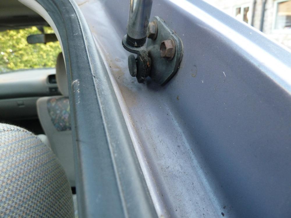

SGS website quotes £32.00 a pair for my car. However, things are not so simple. Apparently my struts are fitted with  brackets that are unique to Toyota. After speaking to SGS today the price for a pair is now £87,99. They say that they can transfer the brackets but I'm waiting to hear if that is extra.
Don

Seems your strut is bolted or welded ?  to that hinge affair,  assume the other end is the more typical ball socket ?

Yes the top is a conventional ball joint. Doesn't look detachable.
SGS have just got back to me, their £87.99 price entails me sending them my old struts and they will fit the brackets to their struts. The bracket is in two parts and one part is welded to the strut, The other part is just bolted to  the car of course. Mine are working ok at the moment but the tops are a bit rusty and they are 20+ years old.

I'm sure one of the car makers used 'nut retained' spherical pins (on the body bracket) not simply welded in. Finding such a piece would allow the Toyota bracket you have to be modified to 'spherical clipon' either end.

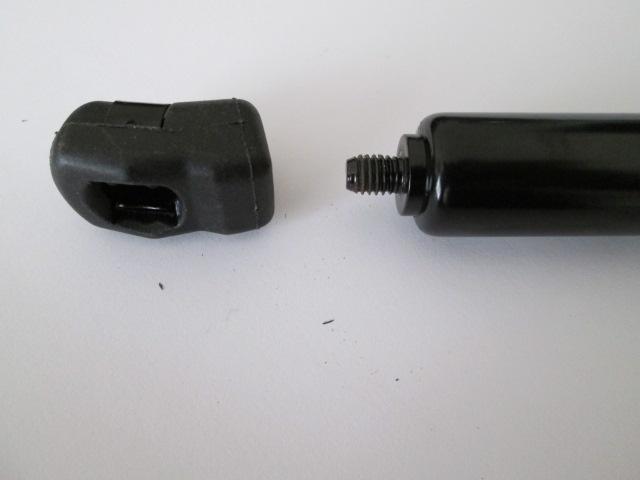

The struts have arrived and are a good fit /replacement to my original  so it seems there its little difference between the two numbers I originally quoted.
Should be noted that these cheapies come as just one type , no L or R,  just a case of spinning the fitting half a turn,

FYI  as you can see in the pic these replacements come with a screw on bottom end, so would think it would be easy enough to drill off your old ones and reattach these new.
No idea if mine are what you need, but the block body less the screw thread measures  about 452mm and the pushrod, including the top end cap is about 200mm; the pressure rating is 440N
