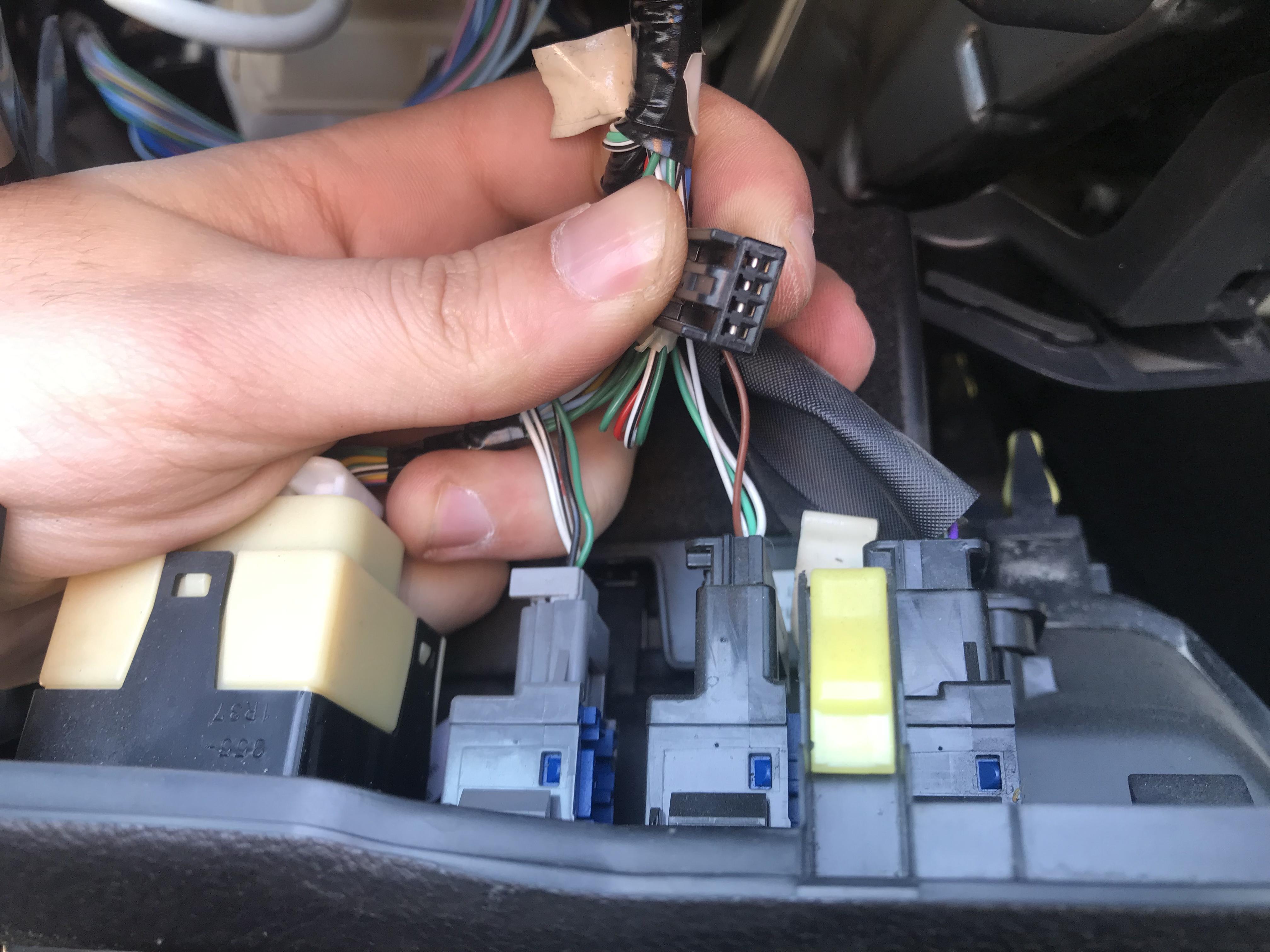

Hello,
its my first topic here so please forgive me if something wrong.

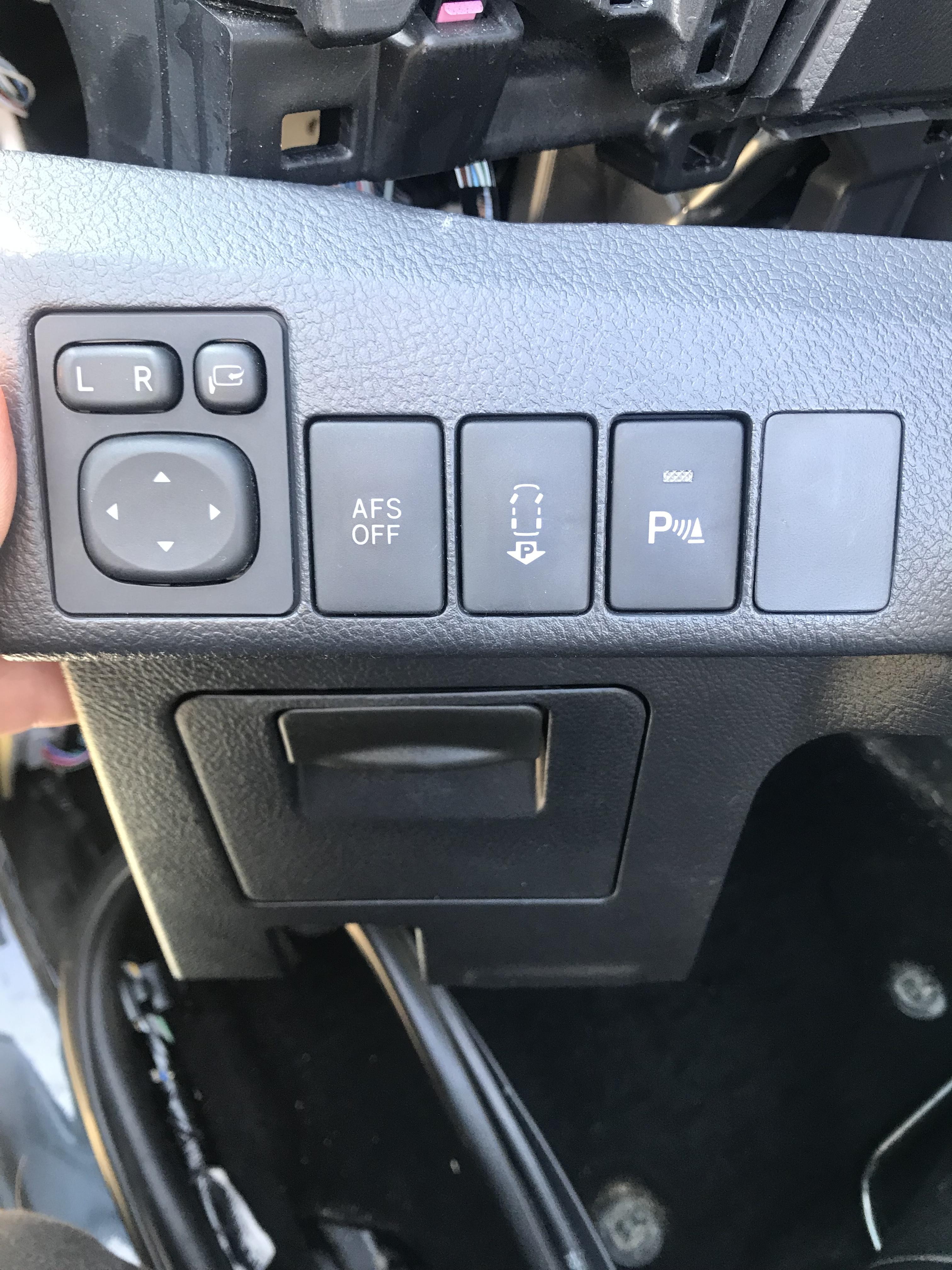

So i have removed panel with mirror adjustment and optional extras, 3 of which are occupied and 1 blank (see pictures below) and also found that behind the panel there was a spare connector (black one) with wires going into it (picture below).
Does anyone have any idea what it is for? And maybe its an option like plug and play, but just have to find the correct button?

Probably for that spare hole, for a feature you don't have. You can try finding the electrical schematics for it.
The only switch listed for your car that is not there is a VSC off switch
So can i just get a VSC Off button and plug it in and it will work??
If your car doesn't have VSC then fitting a VSC 'Off button' is unlikely to work. VSC is a system which uses various sensors and an ECU to operate. Your Auris year model possibly didn't have VSC as standard or maybe it was an option?
