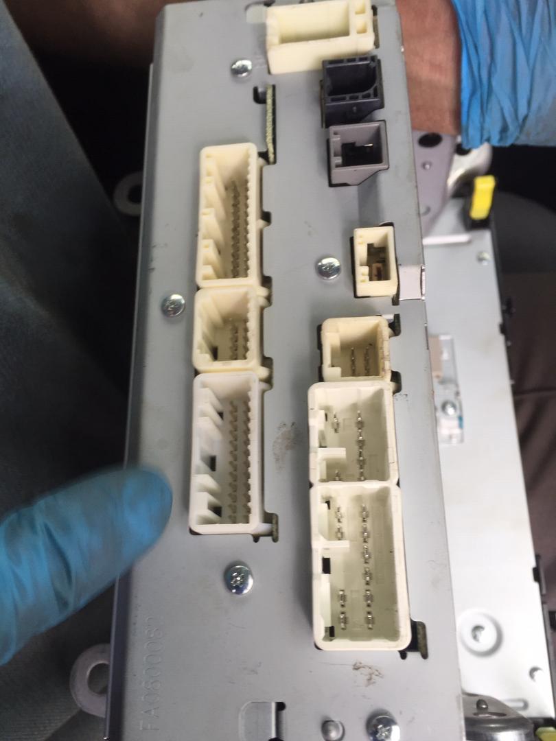

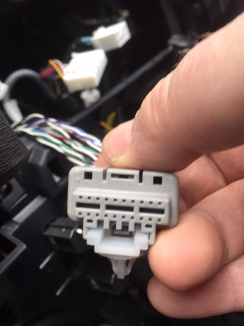

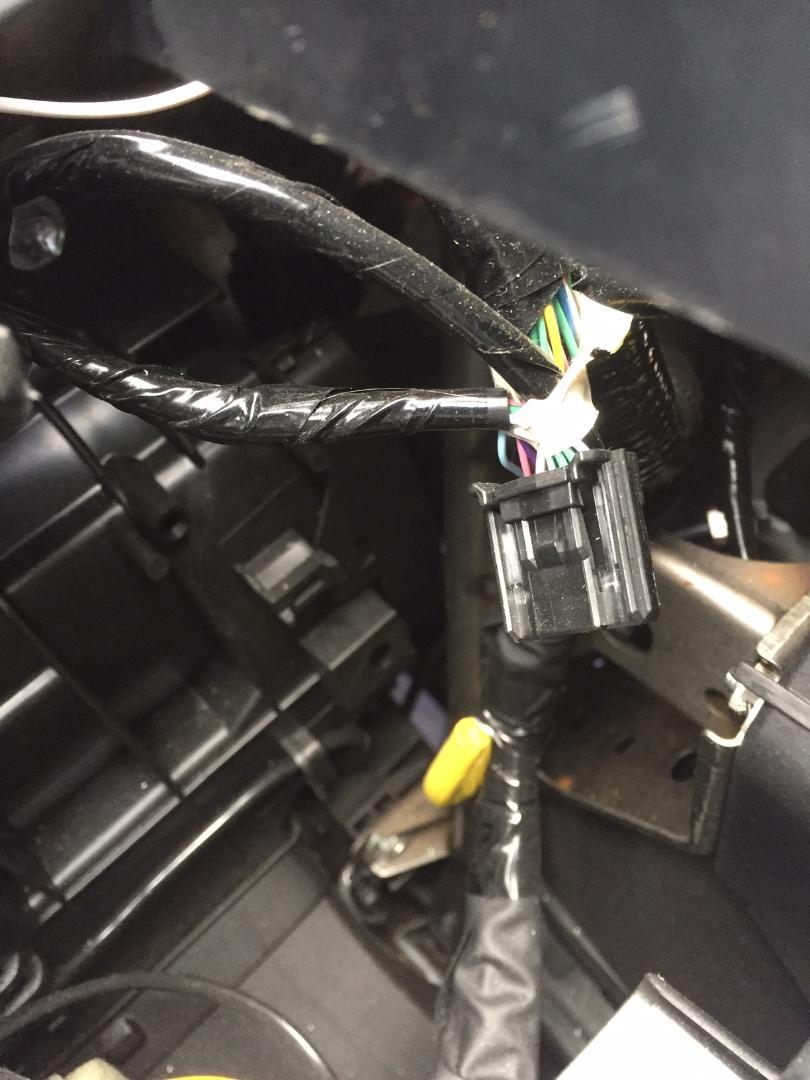

have taken syereo back out until i can understand what i need to get it fully working,,below are pics of back of stereo and the cables that are not bieng used
Looking at your pics you don't appear to have the GPS module ( see ) without this there is no Nav, bluetooth is integrated in the head unit, it sounds like the head unit is looking for a previous paring have a look at the owners manual and see if you can get a new phone paired ( head unit manual )
This has been done before. Have a look at the following -
The units might be different, but the extra sockets on the Nav units are fairly similar.

Thanks for the photos, but they are very small! 🔬😂
Did your bluetooth on the old stereo play music and relay satnav directions from the phone? I was hoping to see clear photos of the rear sockets, as this could make my mind change my unit! The W53828 bluetooth only supports voice calls, and voice directions from iPhone and Windows phones. There is no multimedia/music support. Android phones need full multimedia Bluetooth, so only voice calls are supported. Toyota updated the basic stereos bluetooth to support multimedia. This is why I am interested.
