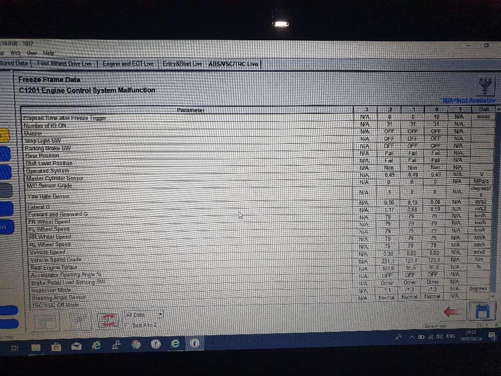

I have one of these and was using the supplied Toyota Techstream software.
I have also attached the Freeze frame data if that will be any help
