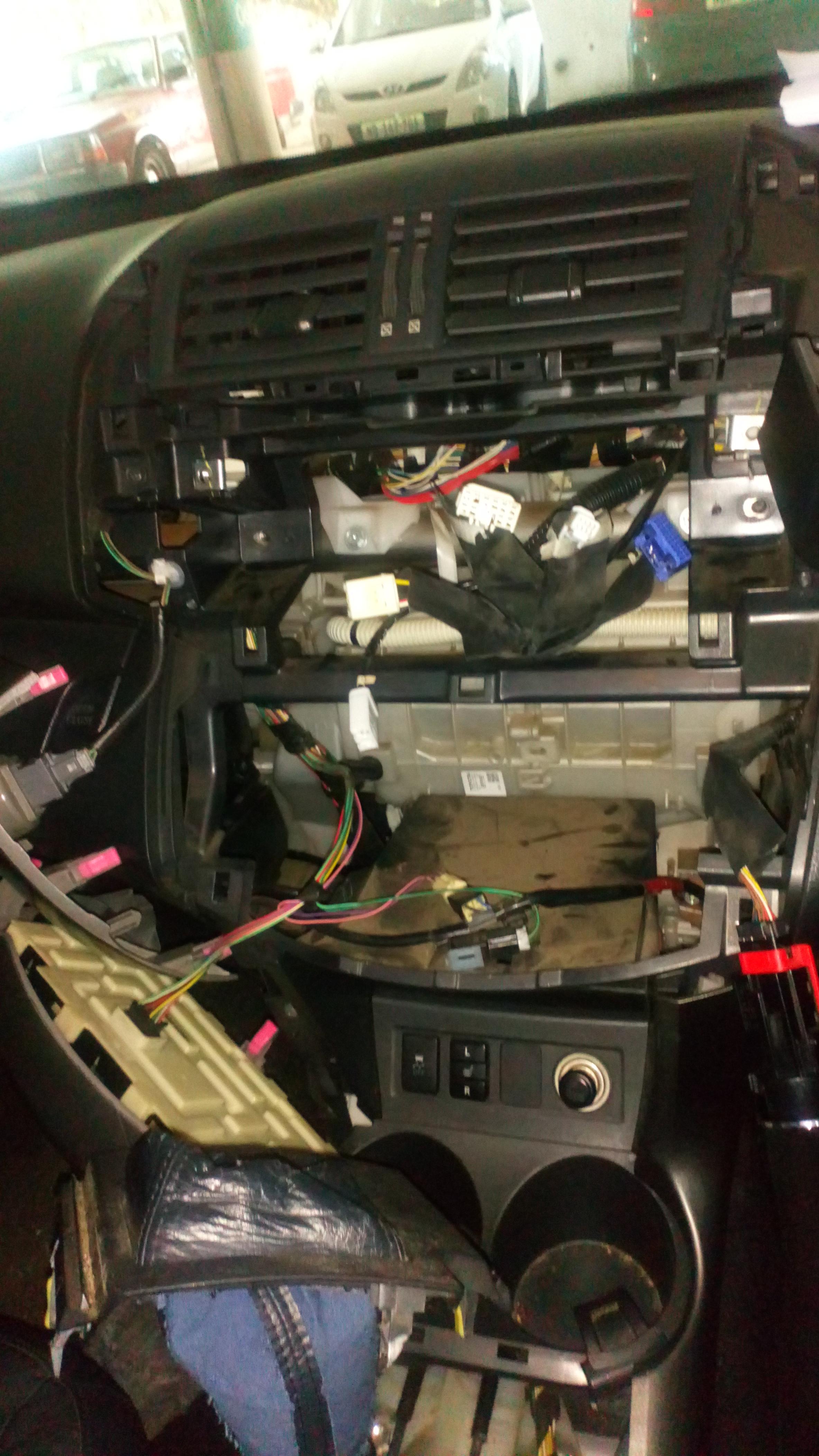

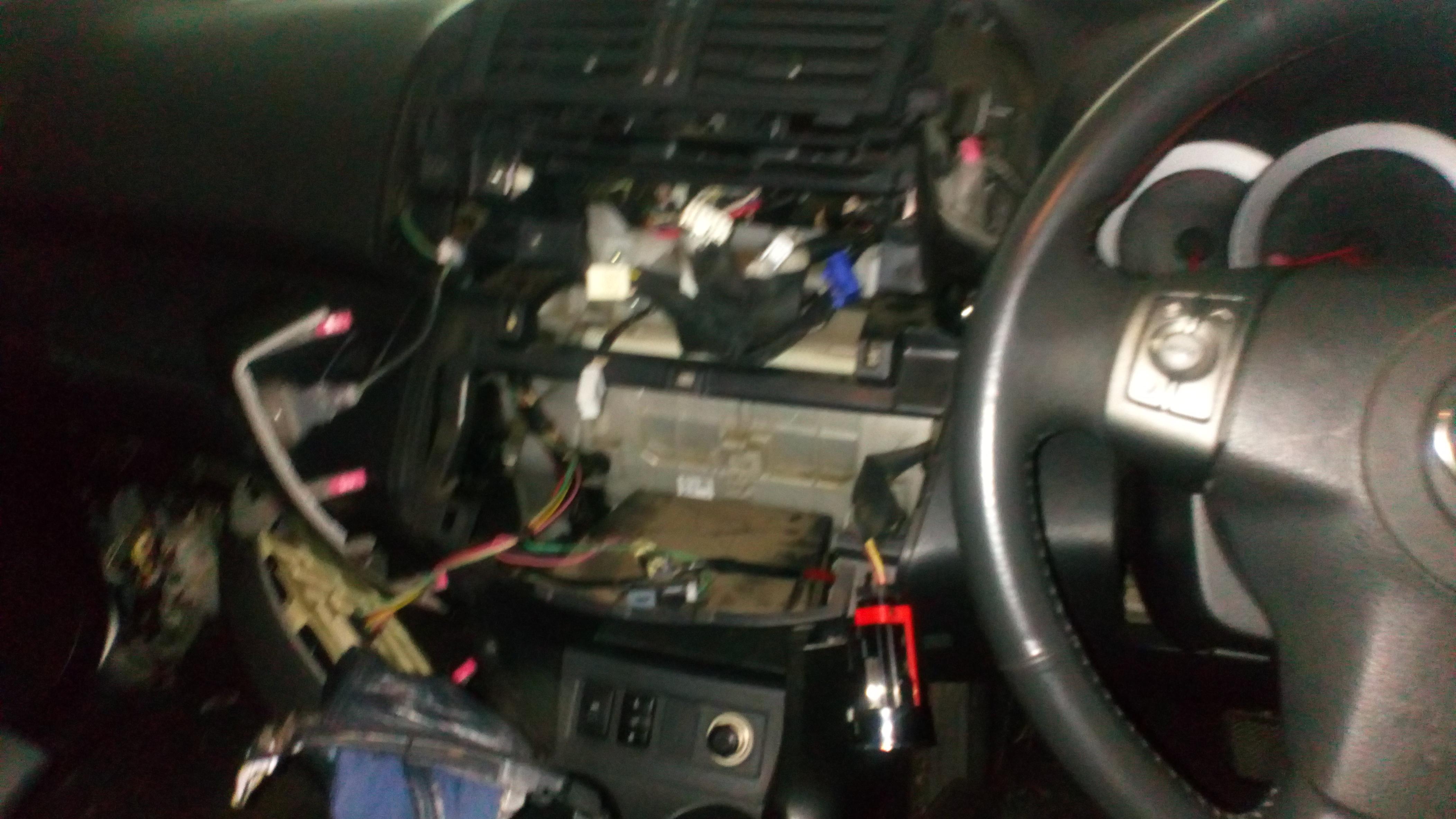

Hi Furtula ... Tried that however the button doesn't glow at all. Had a mechanic look at it and they can't figure out what to do... This is what it looks like now...
