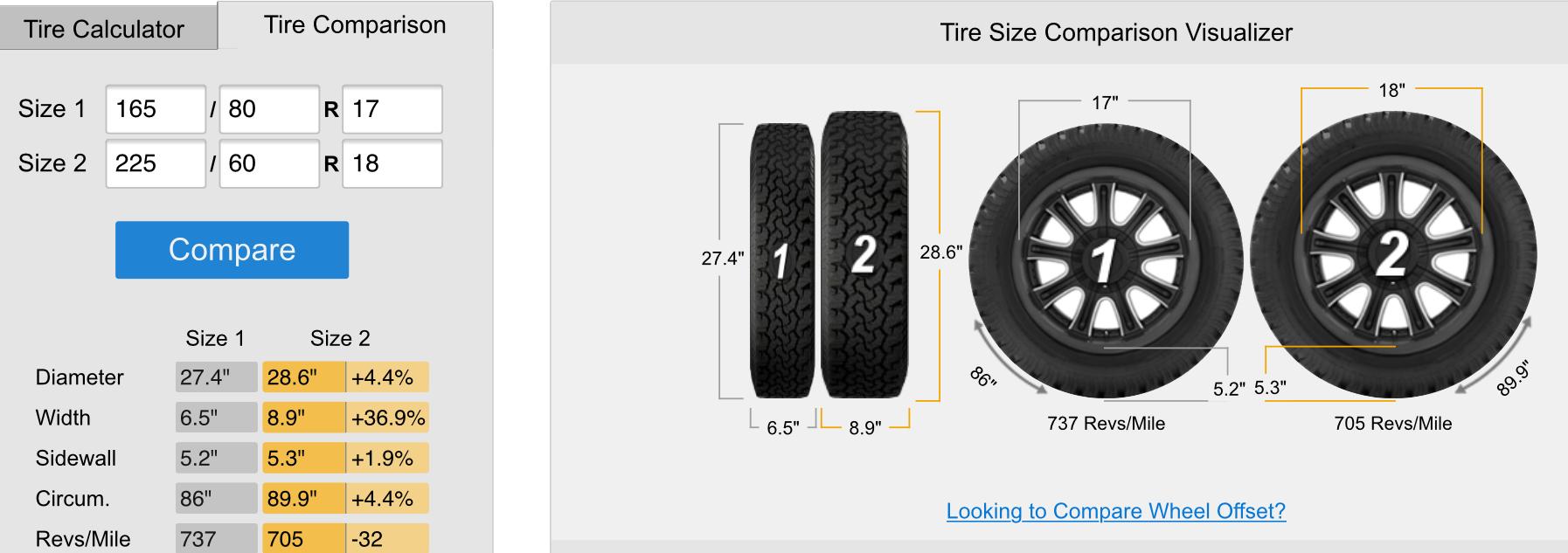

This is a comparison between the temporary spare and a full size wheel.
the full size wheel and tyre diameter  appears to be 1.2” larger and 2.4” wider.
Hmm, from what I remember, the 2.4" extra width is going to make it very tight, maybe even slightly raise the floor by perhaps ½" or so.
I'll wait and see when we can try it when my car arrives, and report back.
