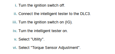

I'd like to run a calibration for the zero point and torque sensor to try to get a firmer feeling in my steering wheel.
There is a manual option, but i'd rather try the one with diagnostic as it seems to be much easier.
My question is, can Techstream do this?  They mention intelligent tester, which i presume techstream also is?
The instructions from Toyota how to do it are as follows:
The answer is 'yes'.
Right then, that makes things much easier, i'll order the cable now, thanks Jim.
