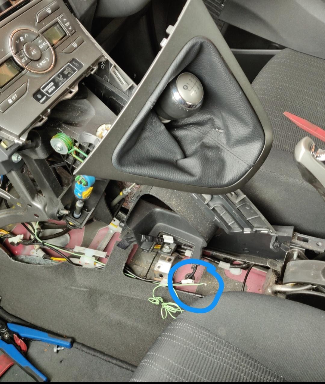

I have a pioneer stereo I've got and I need to wire the parking break wire up to enable me to use some features on the stereo. Can anyone tell me if there is a easy way to bypass this or where I'm splicing the cable into location etc of handbreak wire

You splice in here, it's just a single wire, I did mine with my Kenwood unit.
Hows best to get the panels off do they just pull off then ?
Here are instructions for parking brake removal, it should be enough to give you access to the wire needed.
https://www.autocats.ws/manual/toyota/auris_corolla_zze-zr-nde-ade/rm04f0e/repair2/html/frame_rm000002vhn000x.html
Cheers guys. Getting my sub installed in a few days so will ask the tech to sort it out while he has the inside stripped
