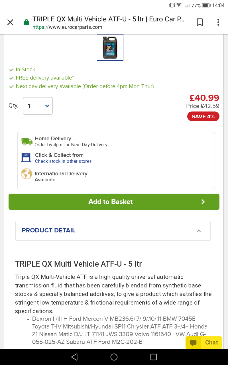

As for the fluid, the handbook says only to use t-iv, then later to use dextron ii or iii 🤔 so I have plumped for a triple QX that covers those specs!
Hopefully you can read the write up at the bottom of the screen shot!

I am not much in favour of the 'multi-vehicle' ATF's. I just don't see how one fluid can meet the requirements of transmissions which use such diverse OE fluids. Many years ago I used a 'universal' fluid in a Honda AT. The shifts were terrible. Switched back to HondaMatic OE ATF and the gearbox was transformed.  If you want to save money you can find lower-cost T-IV spec fluids from suppliers like Mannol - do a search on eBay.
