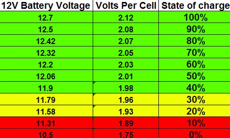

Below you have a general chart to see how charged is your battery.

10.8V at rest suggests a very low charge. Leaving a battery in that state increases sulfation of the plates which means a hard coating of lead sulfate forms on the plates preventing it accepting new charge.
