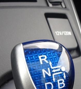

Does anybody know how to remove the 12V/120W socket (cigarette lighter) from the center console of my 2014 auris TS?

Because it's broke and I want to fix it....
You need to remove the big plastic silver like ring that goes around the gear lever, it's on a couple of clips. Use plastic trim removal tool, or if you dont have it, flat head screwdriver with some tape wrapped around it.
Once the plastic ring is taken off, i'm guessing there will be a few screws there, and that should be it.
