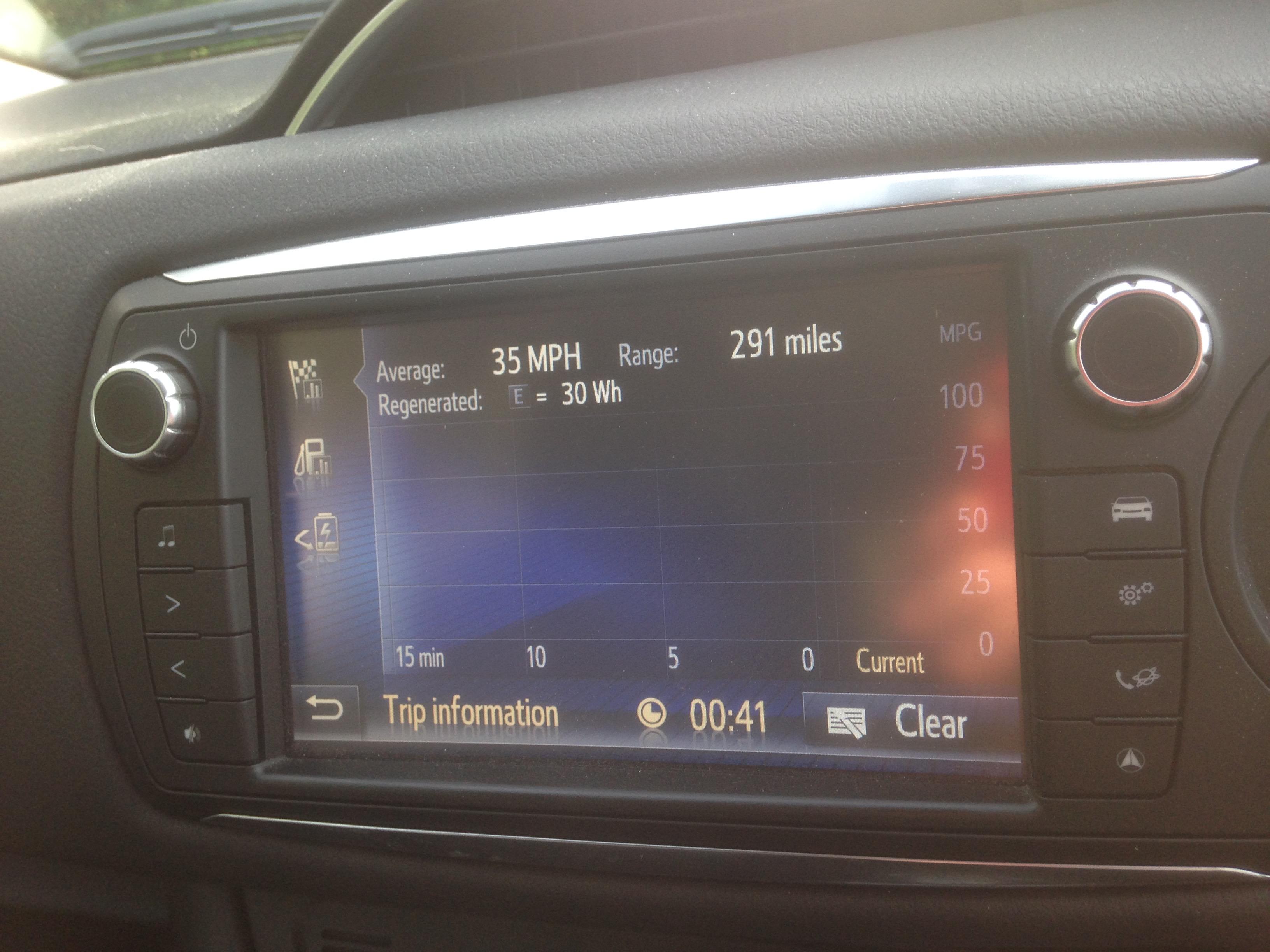

Just driven 58miles to Camelford and back on Grandson Duties, and range now says 291miles.  Where did that come from?
At home, I reset all the trip information.  There's absolutely no way that you can reset the range or the average speed.  Why not?  First car we've ever owned with a trip computer that you can't.
Is the only way to do it, that you have to disconnect the 12v Battery?  Is that 35mph average speed since the car was new 40,000miles and four years ago?  Is this information for the life of the car?
Why on God's Earth can't you manually reset it?
Mick.
My mistake a bit.  Sorry.
I can reset the average speed as well as the average fuel consumption ...................... but ...............
The handbook says that the Range is calculated from your average fuel consumption.  Why does it always show way too low?
Off out again this afternoon and as I've reset the Average Fuel Consumption, it should give me a reasonable range figure.  If I were to reset again on a very flat bit of road and drive very gently and in EV for as much as possible, the range should go sky high ............ but it won't.  It'll remain where it is until it becomes less than the figure shown.
