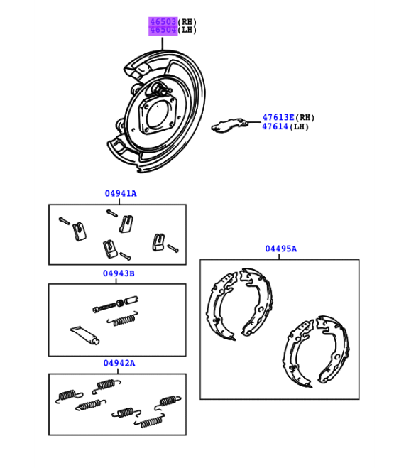

I am wanting to renew the rear brake dust shields on my 2005 Corolla where is the best place to buy them that aren't costing an arm and a leg as it's only a bit of tin but mines are rusted out and I'm replacing all rear brake set up. So not changing these brings the look of the car down. Any help much appreciated 👌
The backing plates on Corolla are more than just dust shields they also form the support/carrier for the rear parking brake shoes and as such are a bit more complicated than just bits of "tin".
You are looking for part numbers :
46503-02020 RH £301.47 +vat
46504-02020 LH £301.47 +vat
There is also a special note on Toyotas parts catalogue ""part is not expected to be available soon due to missing tool to produce the part  - purchasing & supplier checking new tool set-up & alternative parts"
I might just try and sand them down do the disc brake set up at the rear having parking brake shoes inside? I didn't realize there was this much to it. Thanks for your reply Devon Aygo
