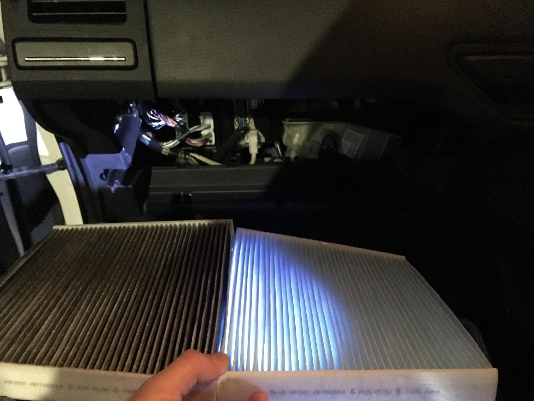

With the African desert dust heading our way and following a pollution of Peugeots I was thinking about replacing the cabin filter with a carbon activated version, however, on removing the old one it's a grey colour and I cannot determine if it is indeed a carbon one or just dirty. As it's now 14 months old and there were just a few insects and odd bits in it, there was little dust coming off it. I cannot believe that Toyota would put an activated carbon one in as standard and the only marking on it I can make out is MUFT4.

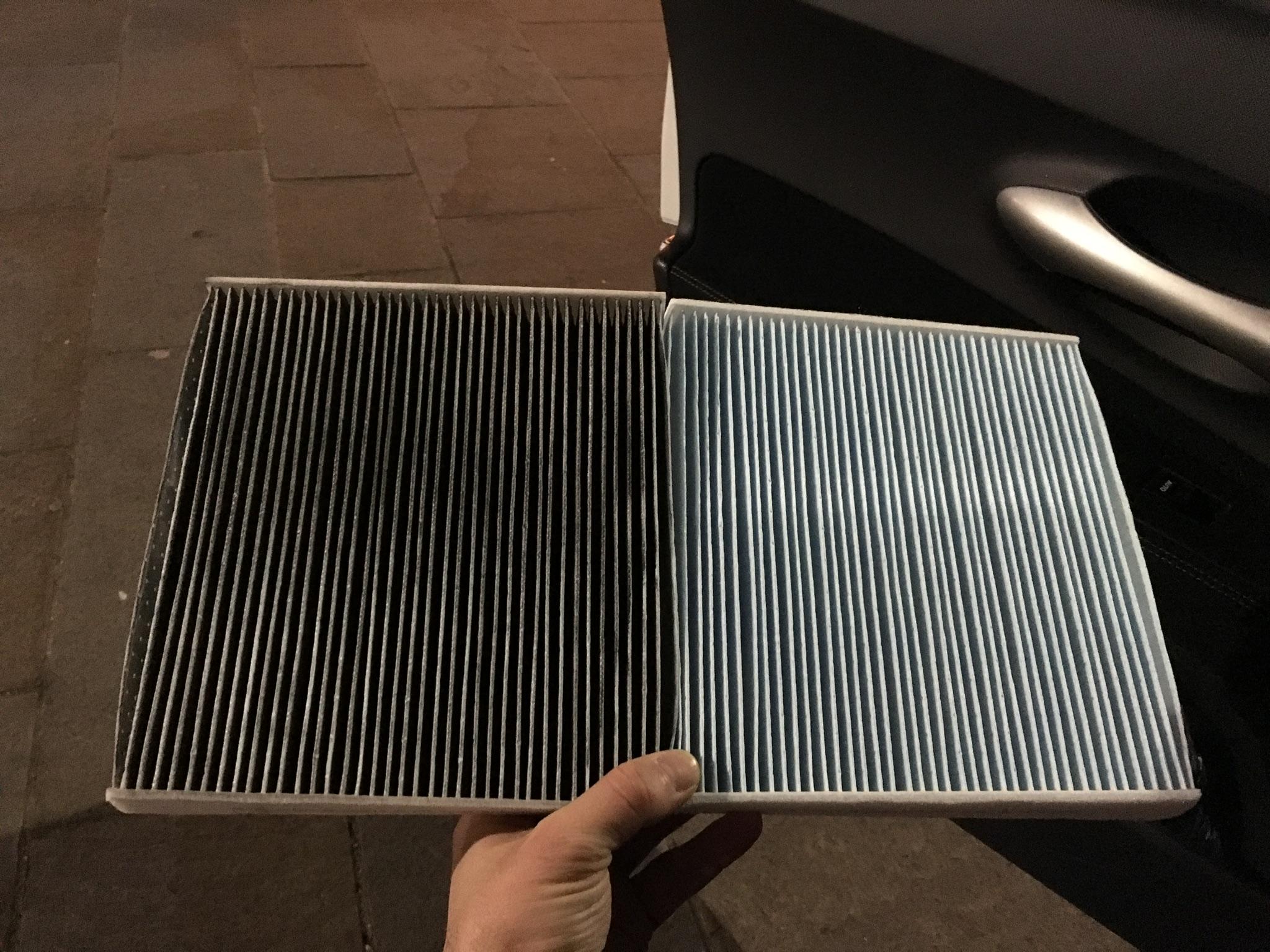

Best way to test is to smell it, if you notice some smell of fuel just get it replaced. I change mine every two months, I use Blueprint standard one not with active carbon and after only 10k miles becomes same colour like the one with carbon. Pollution at its best. This filter it’s most important in the car, it actually protects you not the car. With normal driving minimum once a year.
Please look at the difference between new and 10k miles old, mostly motorway journeys.

My standard OEM paper filter was a dark grey after one year of use (with free dead wasp). With the amount of diesels on the roads these days, I'm not surprised.
