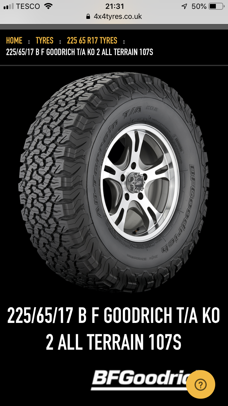

I was wondering regarding tyres are any people running off road tyres on there RAV4s such as:
I think I’m at least going to run winter or all season tyres all year round as opposed to summer tyres to try and reap the benefits in the winter.  I wondered if anyone had any experience with with off road tyres and what the negatives are?  Do they provide poor grip on road or affect handling?

Your choice of tyre should really depend on how you intend to use the car. If 80% of your use will be off road then AT tyres might be a good choice. But they won't give particularly good traction in winter - OK on soft snow, pretty useless on ice or wet roads for that matter. While I have never run AT tyres, I understand from those that have that they are noisier and less comfortable than more road oriented tyres when on road.
For most of us, at least 80% of our motoring is on road so an all season, SUV, tyre is probably the best bet - especially now that there is such a wide choice to choose from. Michelin Cross Climates are a good choice and are certified for winter use (they have the 3 peak mountain and snow flake symbol) but there are others (such as the Nokian Weatherproof) that are equally well suited to winter use and have a perhaps more aggressive looking tread pattern if that is what you are looking for ...

Thanks that’s really helpful and answers what I wanted to know.  Yeah to be honest I just like the aggressive look of the AT tyres, I won’t be going off road all that much so it sounds like they would be a waste of time for me.  Think I’m gonna go for the Michelin Cross Climates, they look sweet with the white lettering on the sidewall too imo 👍
