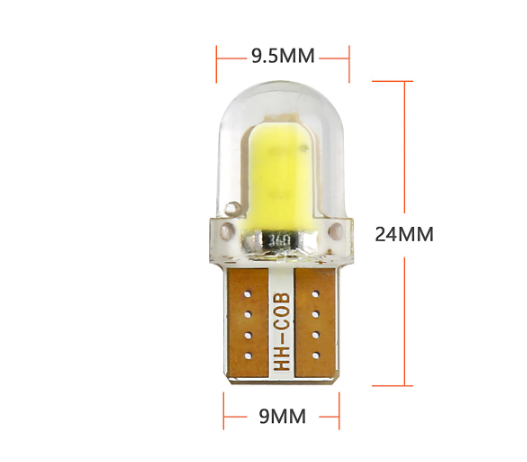

Interior lights are standard W5W, so you can buy couple more and upgrade license plate lights, or front parking lights, since it's the same bulb.
But if you want to upgrade the license plate ones, you need to get a bulb that's encapsulated in silicone, or similar (below you can see what i have)
 And for the interior lightning dome,it's C5W i have the one from the picture, size 28, but you can also squeze 31mm one.

Do you have a link for the license plate ones perhaps off fleabay?
I bought them off aliexpress, they were 1.5 euros for 10 pieces with free shipping, and are crazy bright when used on outside of the car.
I don't want to share a link, but if you put this below, in searchbox, it appears within first few results.
10pcs LED W5W T10 194 168 W5W COB 8SMD Led Parking Bulb Auto Wedge Clearance Lamp CANBUS Silica Bright White License Light bulbs
