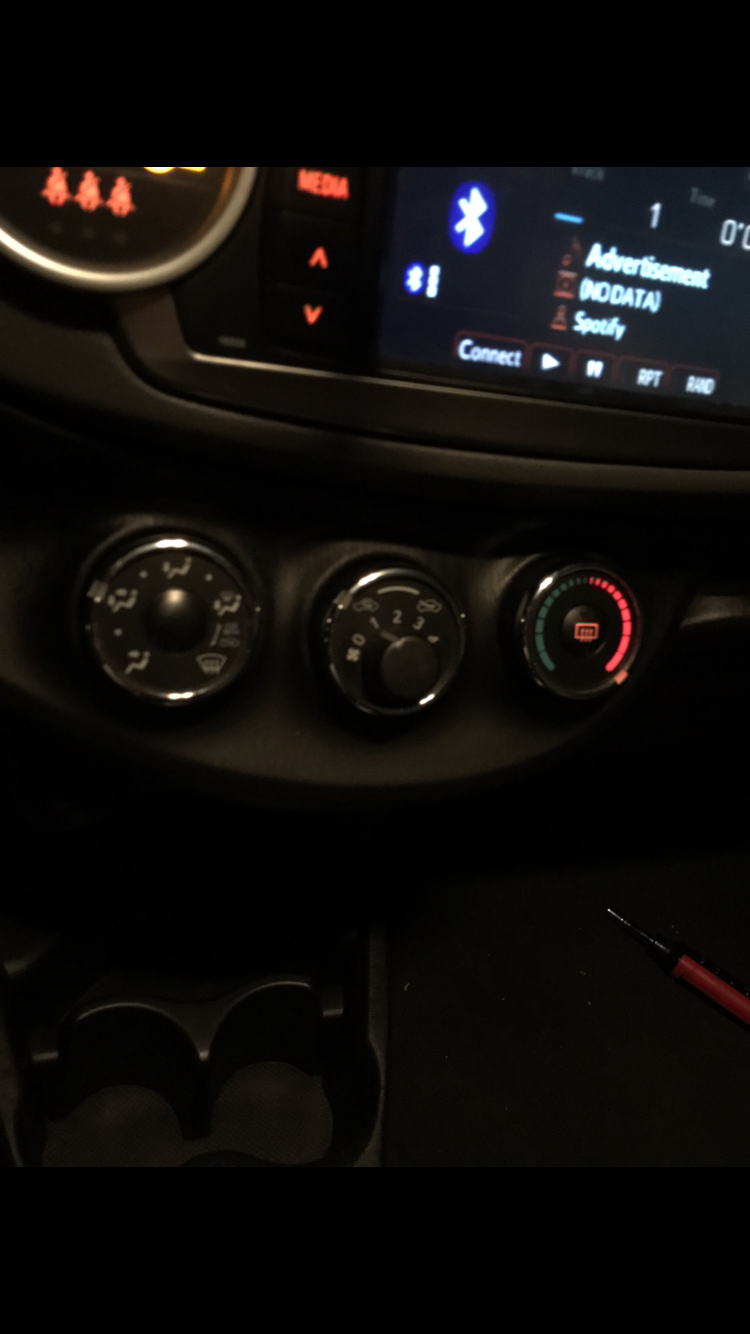

Hi, anyone know how, or have the manual to take the panel out the climate controls are sitting on? I tried taking the display out out too but no luck
thanks, hafnia
The surround and the controls pops off with a trim tool.
https://www.ebay.ie/itm/TOYOTA-YARIS-A-C-AIR-CON-CLIMATE-HEATER-CONTROL-PANEL-SWITCHES-55406-0D490/283530035592?hash=item4203b50188:g:KBoAAOSw5zVdFTOx
See the pictures
There are no bulbs they are all smd (surface mount) LEDS
To replace the lights, you need a hot air blower, local shops that fix electronics, tv's and etc should be able to replace the led's for you.
