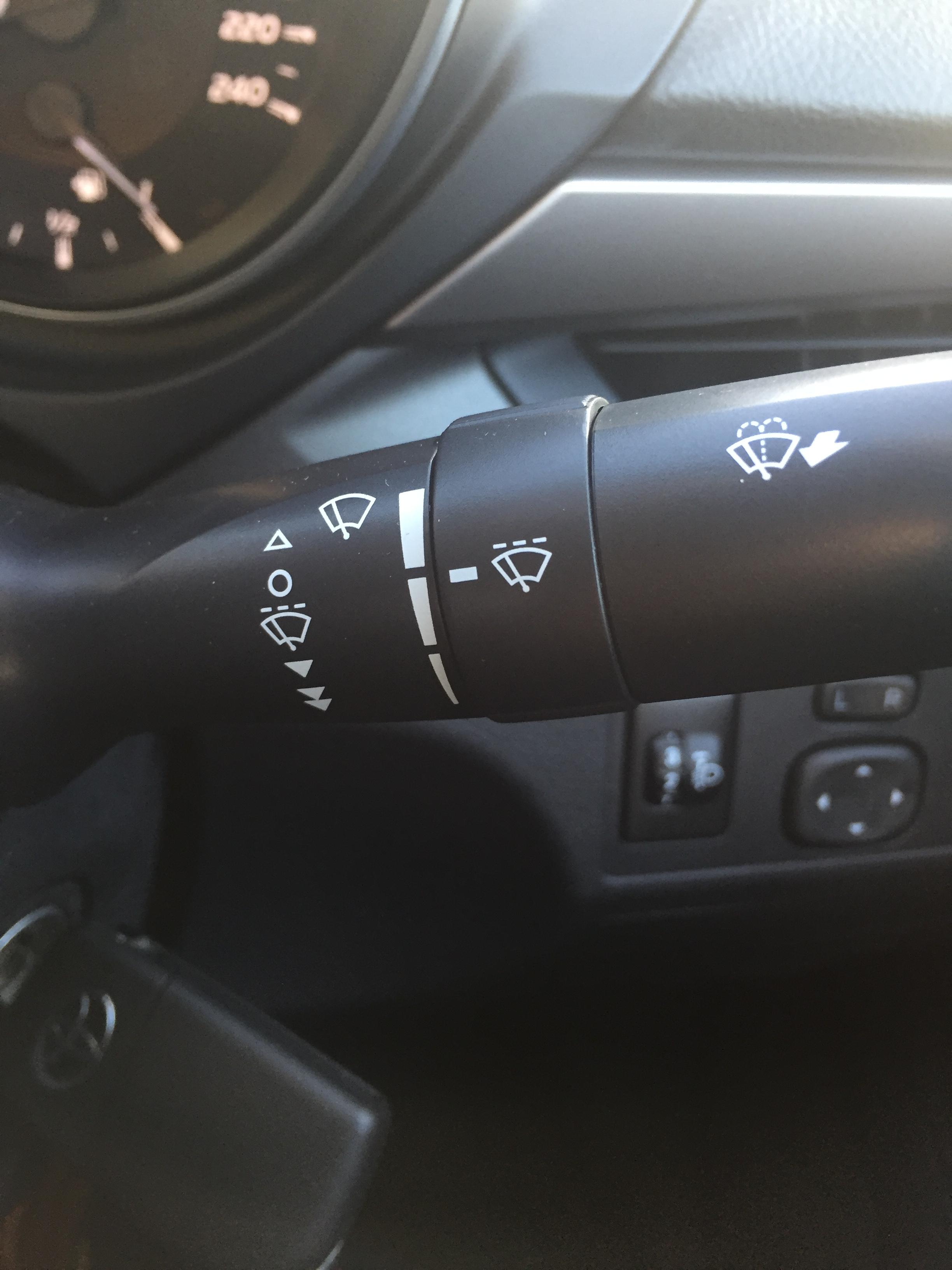

If there's a position marked "AUTO" on the bit of your wiper stalk that you rotate to set the wiper speed, then you do, if it says "INT" these it's ordinary intermittent.  Smaller ring in the stalk with widening marks sets either the auto sensitivity or intermittent interval.

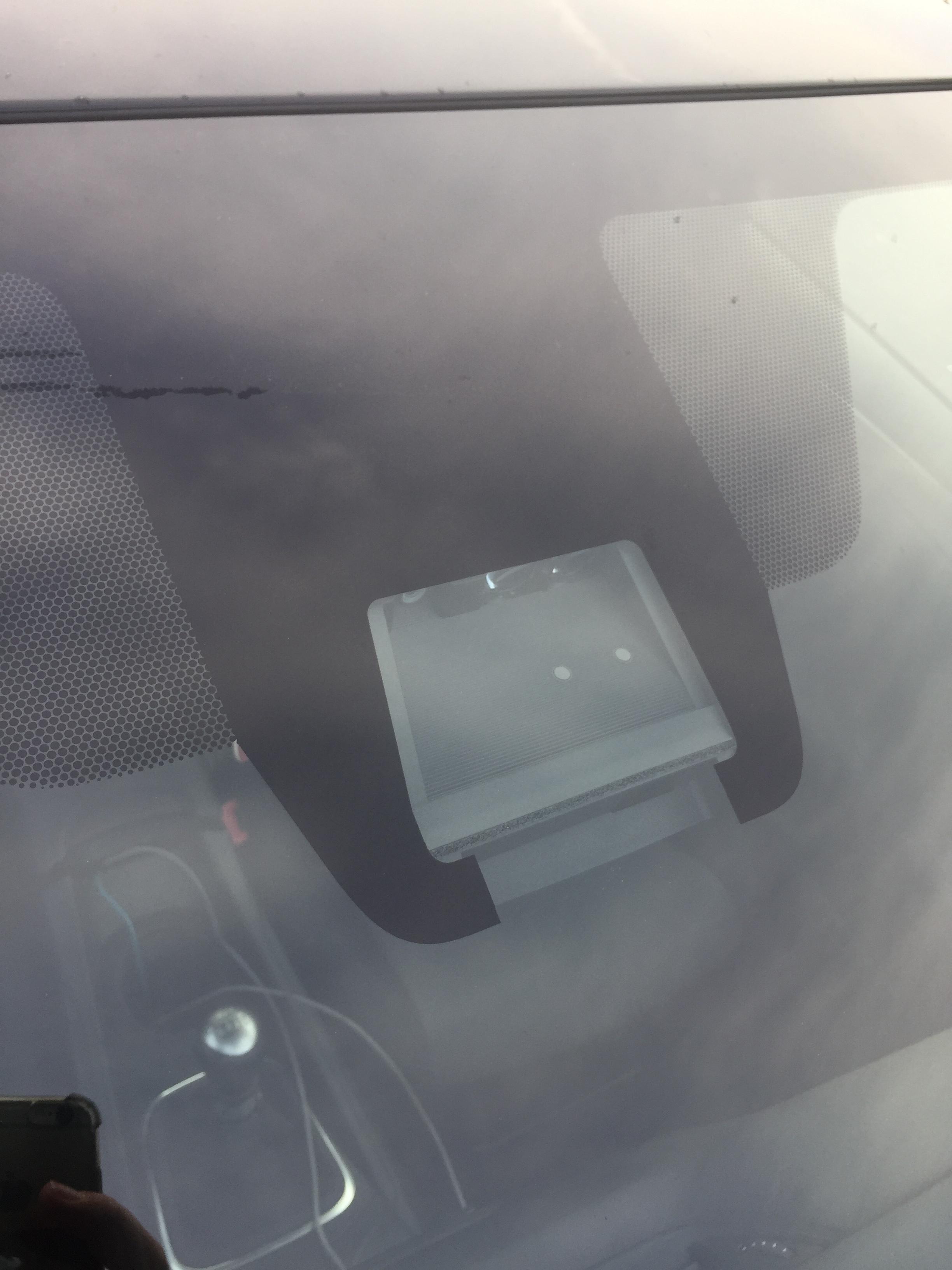

I don’t have INT or AUTO on the wipers control but I do have this box at the top of the windscreen.
Might be a few dashes then (between off and slow speed).  If you don't have Auto wipers I'd be surprised if you don't have intermittent.
