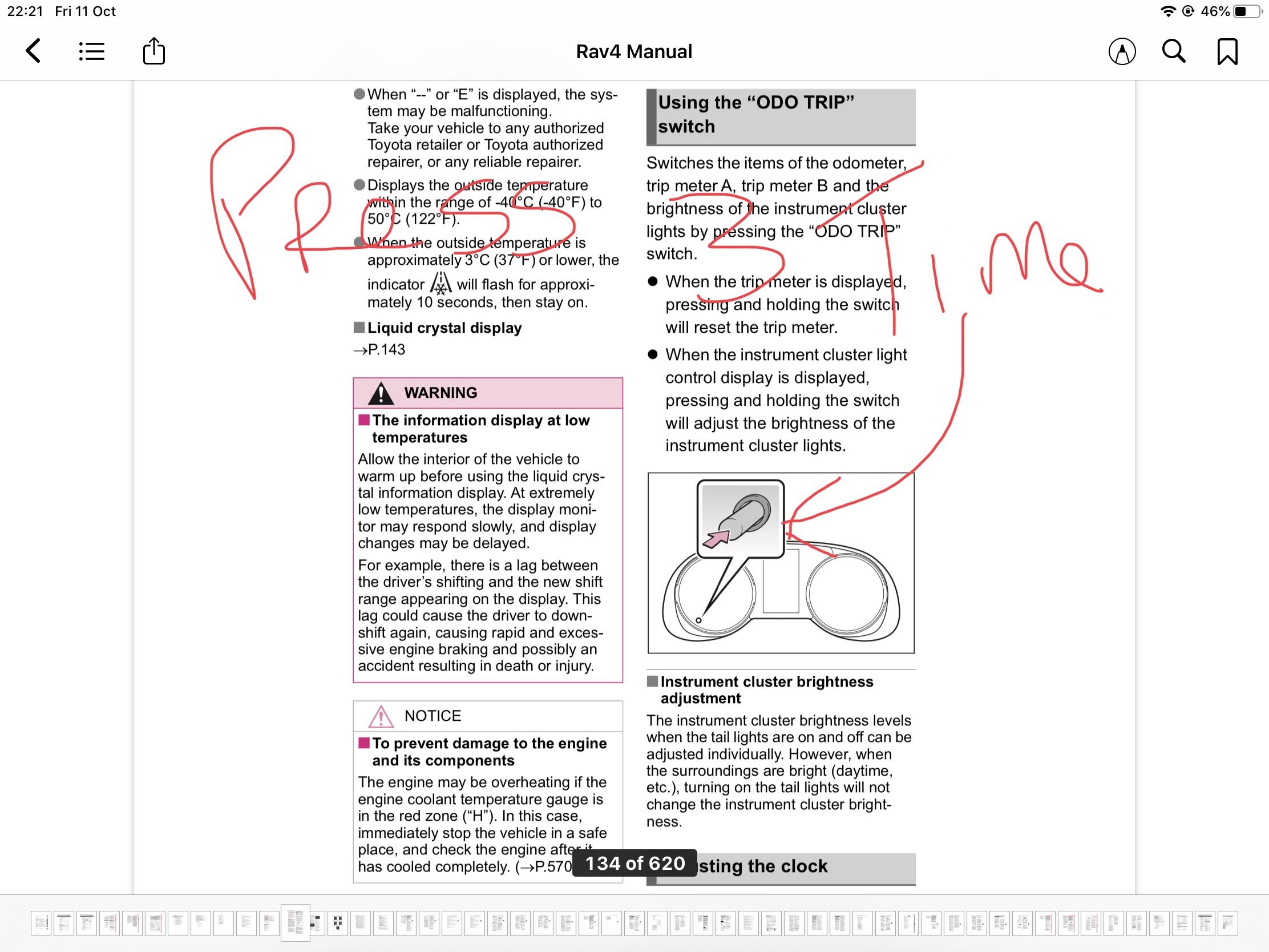

Good morning I am trying to adjust my dashboard lights a little dimmer, but not succeeding 😮 any advice please  I have attached a photo from the RAV4 online manual page 134 .thank you.

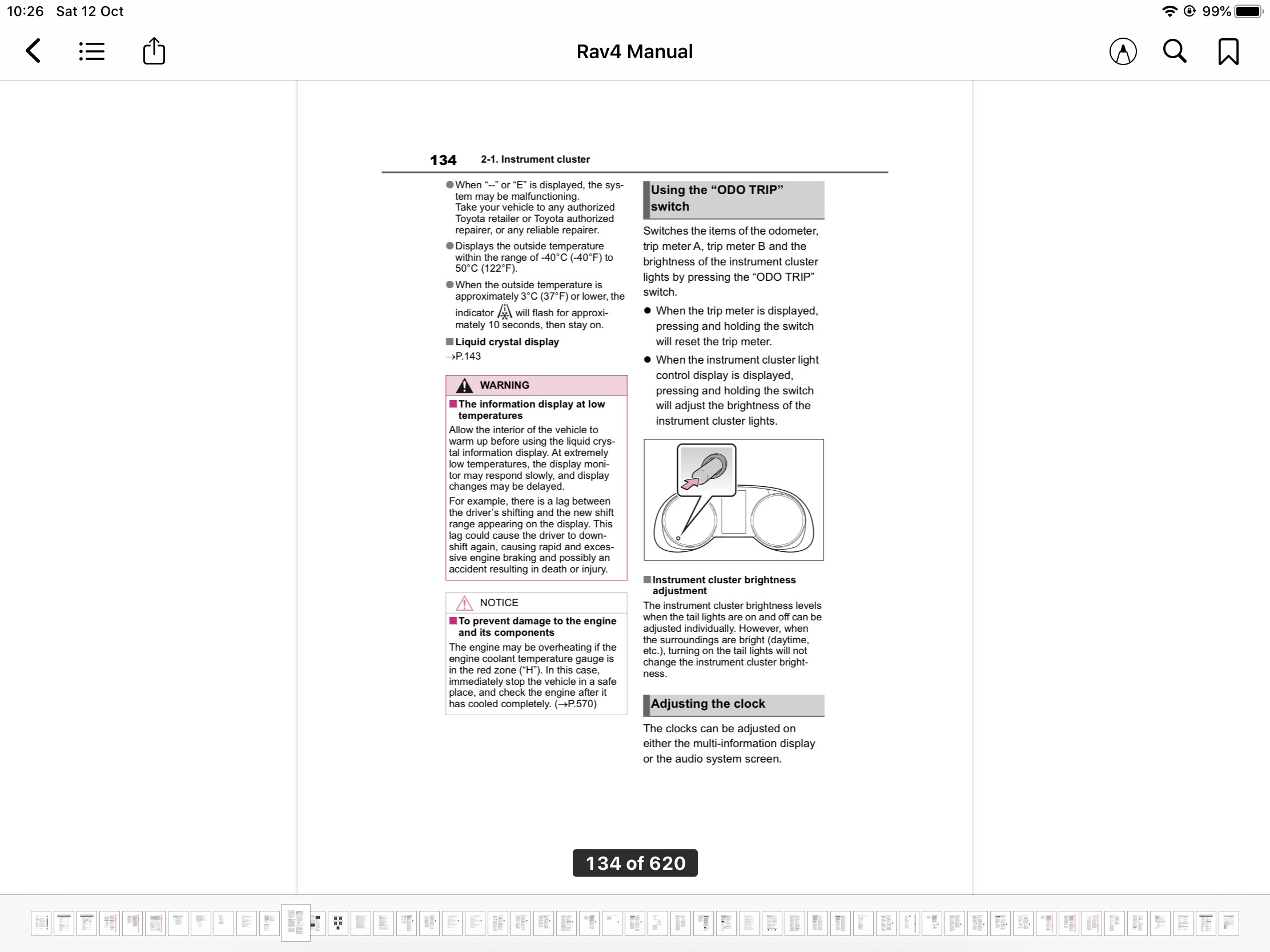

dash light cluster dimmer  sorted. I turned on side lights pressed the trip switch 3 times to bring up the light cluster menu. See photo thank you again 8EF0D38C-8D39-412C-9B89-147FFFDC1AB0.thumb.jpeg.caaaf3fa4f850a61a6c70910ca362693.jpeg
