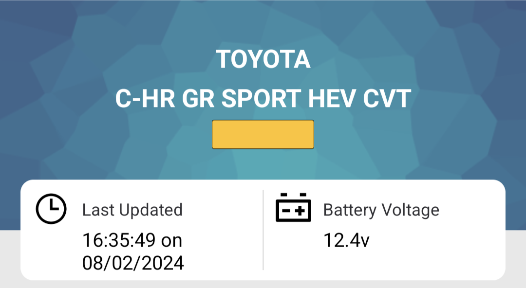

I'm only doing short journeys ( 10 miles max a couple of times a day ) but the Battery normally drops to around 12.2 volts over night.
Currently showing 12.4 volts after a couple of hours since parked.
It’s “time” not “distance “ that’s important….
20 miles per day should be more than sufficient to keep your Battery up.  12.4v seems to be the level Toyota design into the system.
@forkingabout how did you get that Battery voltage info?
2 hours ago, UncleZen said:
@forkingabout how did you get that battery voltage info?
Part of the extra security system fitted to the vehicle.
