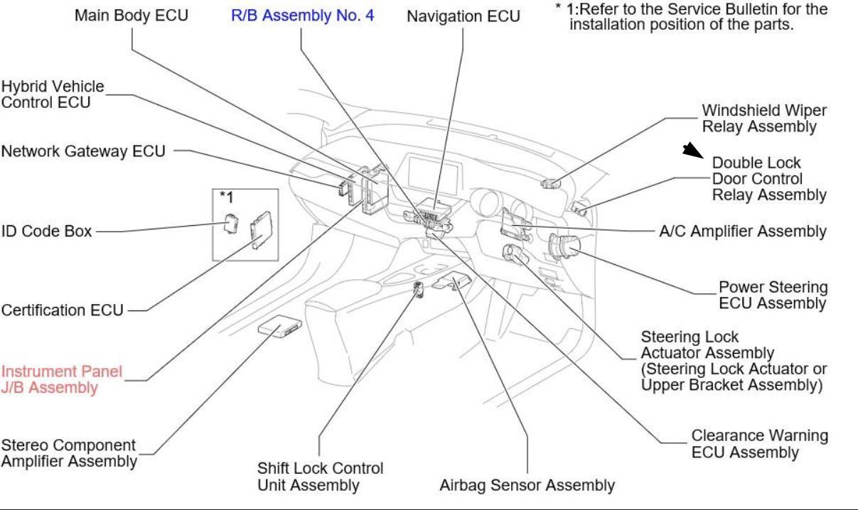

Do you know if the C-HR has a double lock facility, I.E if you press the lock on the key fob twice within a couple of seconds, it locks the car but with minimal Battery drain.
I’m sure my Honda had this but I am relying on my memory, so it may not be the case and I noticed this in a post earlier today.
Yes - like both of my Auris. See page 145 of attached owner's manual.

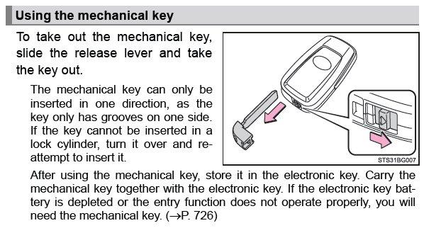

Spo2, the manual key generally only opens the driver's door.

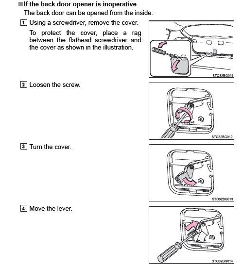

The Battery in the boot you can get access to open it, but its not the easiest as you've got to crawl through from the back seats and I think theres a little cover or something to prize off and open it from there as I witnessed the road assist doing it I didn't take great note what he done but he did open it from there. Try YouTube there's always someone showing how to do things on yer motor🙂the one in the boot is for the electrics for everything and the one under the front bonnet is the one that starts the car or to jumpstart it.
Kevkit is right. There is a cover inside the boot lid which needs a screwdriver to open . Once open, there is a lever that you pull, which opens the rear boot lid.

One tip about an emergency key unlock your hybrid Toyota., from time to time spray some wd-40 into the manual lock and lock and unlock the car few times to make sure the whole system is operational, otherwise there is a risk of stop working and when you need it you will be met with difficulties to unlock your car with the built in remote manual key. I do once every 3 months and works spot on.

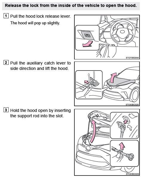

Ours is in the front - 1.8 engine.
If you use the manual key to unlock the front door, you should then be able to open the bonnet from inside the cab. Hope the diagrams help
