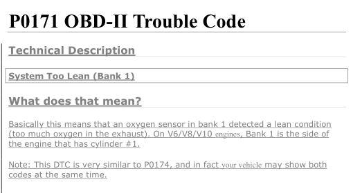

If you look up that error code will see that a lot of the causes  is due to a  problem with the MAF sensor, though there are other things.
Seems in the early stages you probably will not notice any obvious engine problems when driving.
You can easily clear the error code by disconnecting the Battery or by buying a cheap plug in OBD2 tester.
Wonder why your AutoZone (USA?)  garage have not suggested what the probable cause is and whats needed to correct it ?
https://www.amazon.com/s?k=obd2+scanner&s=price-asc-rank&crid=1CSPLPQ0U2SES&qid=1571300438&sprefix=obd2+%2Caps%2C244&ref=sr_st_price-asc-rank
https://www.autoblog.com/2016/04/06/p0171-obd-ii-trouble-code-system-too-lean-bank-1/?guccounter=1&guce_referrer=aHR0cHM6Ly93d3cuZ29vZ2xlLmNvbS8&guce_referrer_sig=AQAAANUIsiUgU4tSEqGCXpe4OyO1Fg0o-m9qez5INQ441Wm1rZvOPO0OzsJpmoemgLiiQTLkoxlT9hbCDNeLX5gw2vxlcaJHyHKAeECy3RB82Mj6eF_HHJvh4RCsmy3-hxbj0sqpe2b2VB5jN6Cl9rqkDRM9Qlu5hVVNf-GDBX9iMISk
