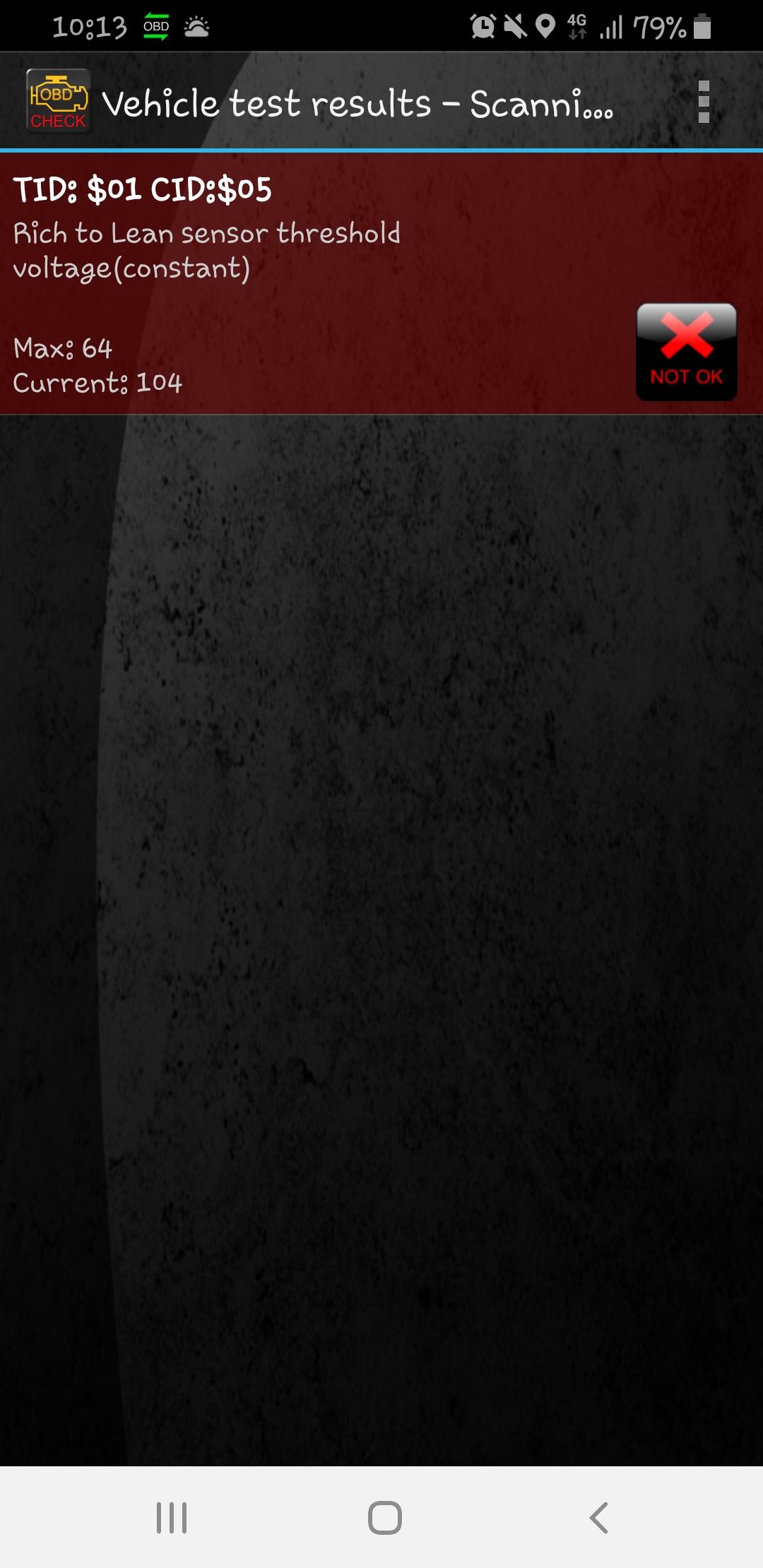

Also to mention, I have this error code that keeps coming back (P0420), and using torque pro I also have the rich to lean failure come up within test results (see attached screenshot)Screenshot_20191030-101317_Torque.thumb.jpg.d954f771dace788febd859285f7bcbae.jpg

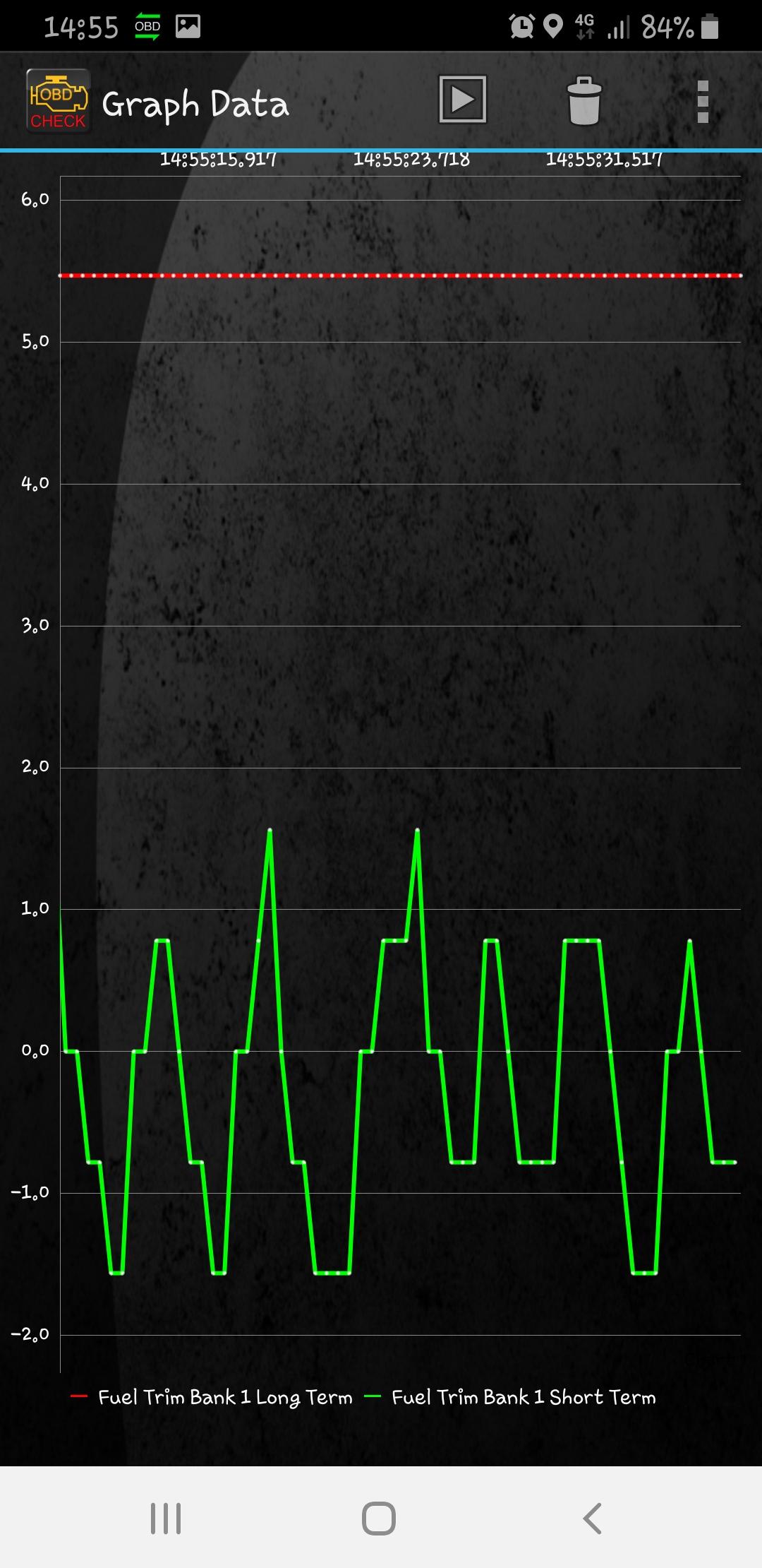

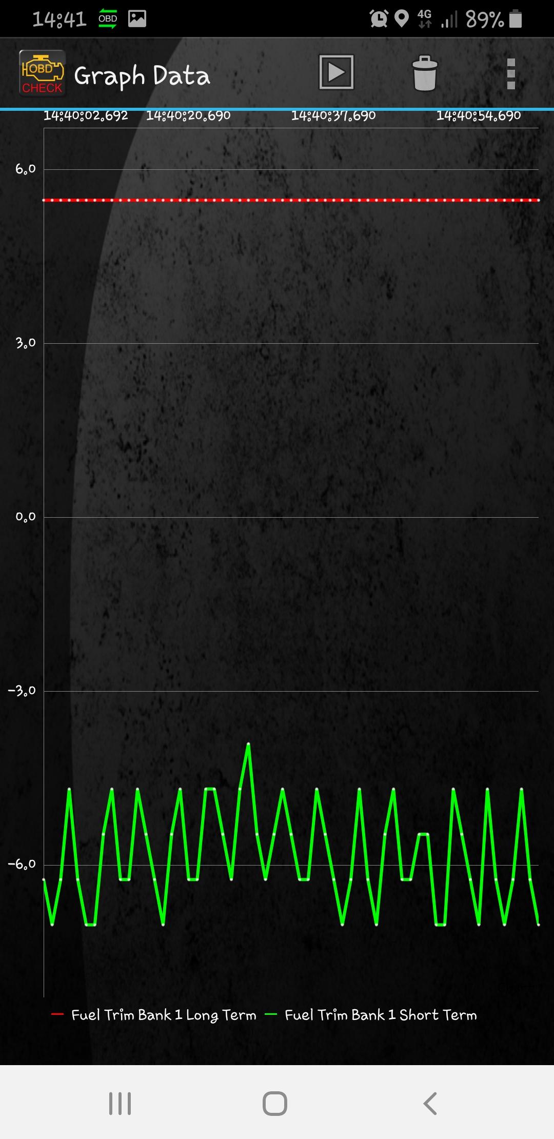

So I have logged the fuel trim results (both short term and long term). It seems while one is never changing, the other follows a similar pattern to the O2 upstream sensor.
This is when the engine had only just started (and at idle):
And this is after the engine had warmed up to 86°C (and at idle):

The fuel trims look fine, my mistake about the MAF was thinking of another engine
As for testing O2 sensors you just need to check for resistance - but im leaning towards a blocked cat
