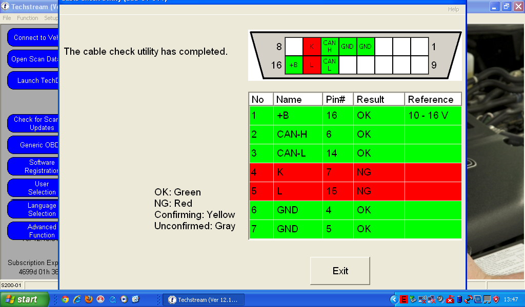

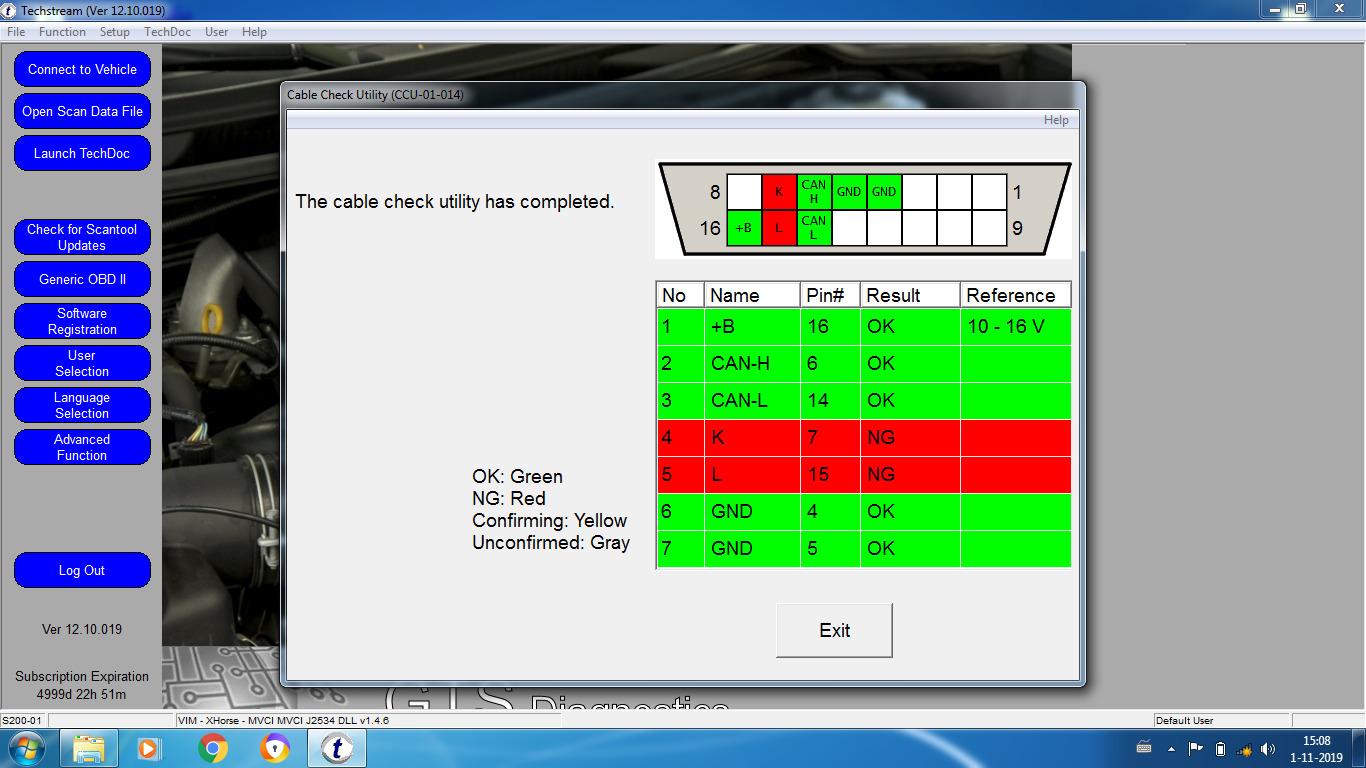

and if i perform the cable test in the techstream program then i get as in the photo, k and l are not good
Just to add to the other responses, my 3 year old Techstream cable also shows exactly the same K and L errors on those 2 pins when the test is run (I returned my first one and bought a different brand when it failed this test, but the next one was the same!), but it works perfectly on our 2013 model cars.

i have now installed it on windows 10 but still the same,
k and l line are red in the cable test. so the hardware is not compatible with my 2010 avensis

The Mini vci does not support K and L lines it's the limitation of the chip, There are workarounds for TS in Windows 10 64 bit it's mainly the driver installation issues

The K and L line are used with the earlier OBD2 models like my 02 T22. It uses the ISO 9141-2 protocol like all of the T22s although I noticed some of the later 02 models, 52 plates, that they had some of the 2 wire hi/lo cabling used by canbus but whether that meant they actually used an early canbus version or the harnesses were starting to be made compliant for canbus in preparation for the T25 I'm not entirely sure.
