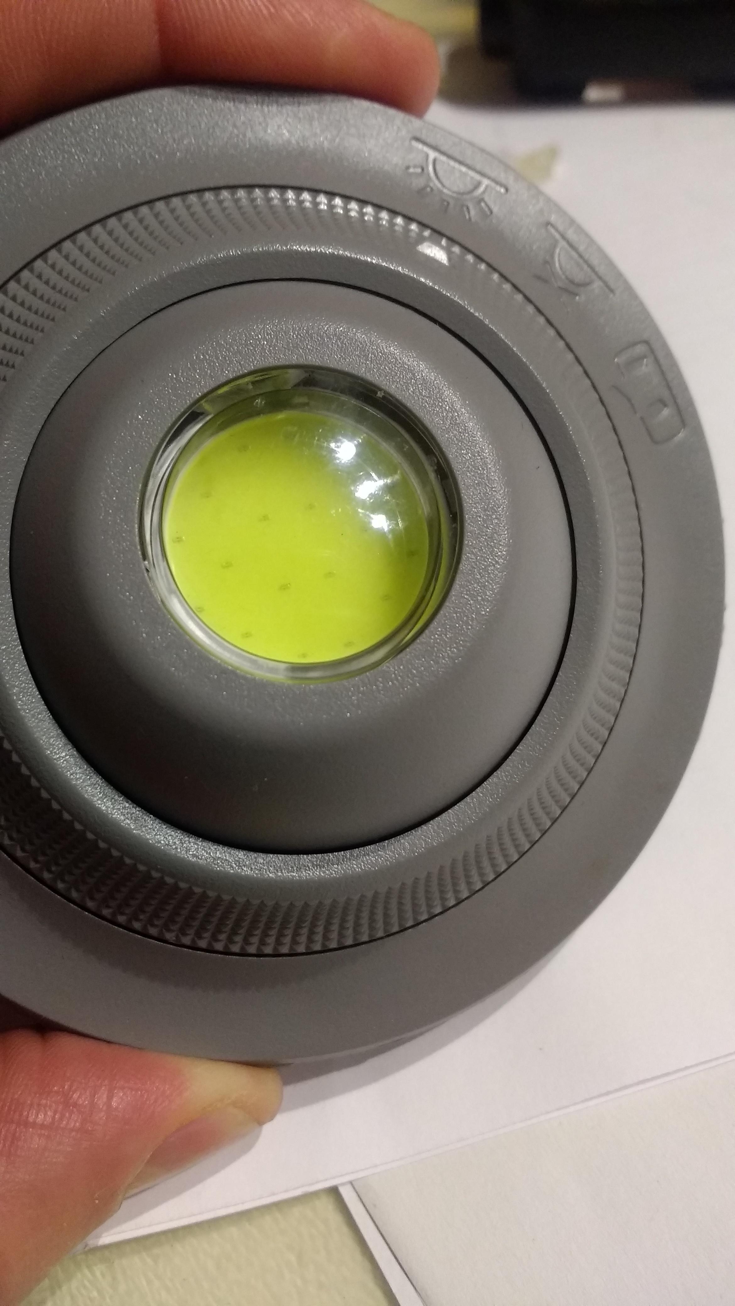

Hi everyone,
i have spent a bit of time trawling through all the discussion posts on this topic.  The interior light has been the most irritating aspect of what actually is, a great car!
I´m not an electrician but i have found a solution to massively increase the amount of light by upgrading the existing dome module.
All you need is basic competence and a few basic tools (flathead screwdriver, soldering iron, plyers, an easily available cheap LED module off ebay) and about an hour or two  of your time to do the work.
The result is a new LED fitted within the existing dome housing (with only slight modification) that does not blind you and lights up the cabin across both seats, the dash area and as high as both door handles.
So far it has been running fine in my 2009 IQ for the past 6 weeks.  The new LED even dims up and down when in operation.
I have attached two photos, one of the end result and one showing how it lights up the cabin (photo does not really do it justice).
I have put together a 12 page PDF with 12 steps to follow including detailed photos of each step.
