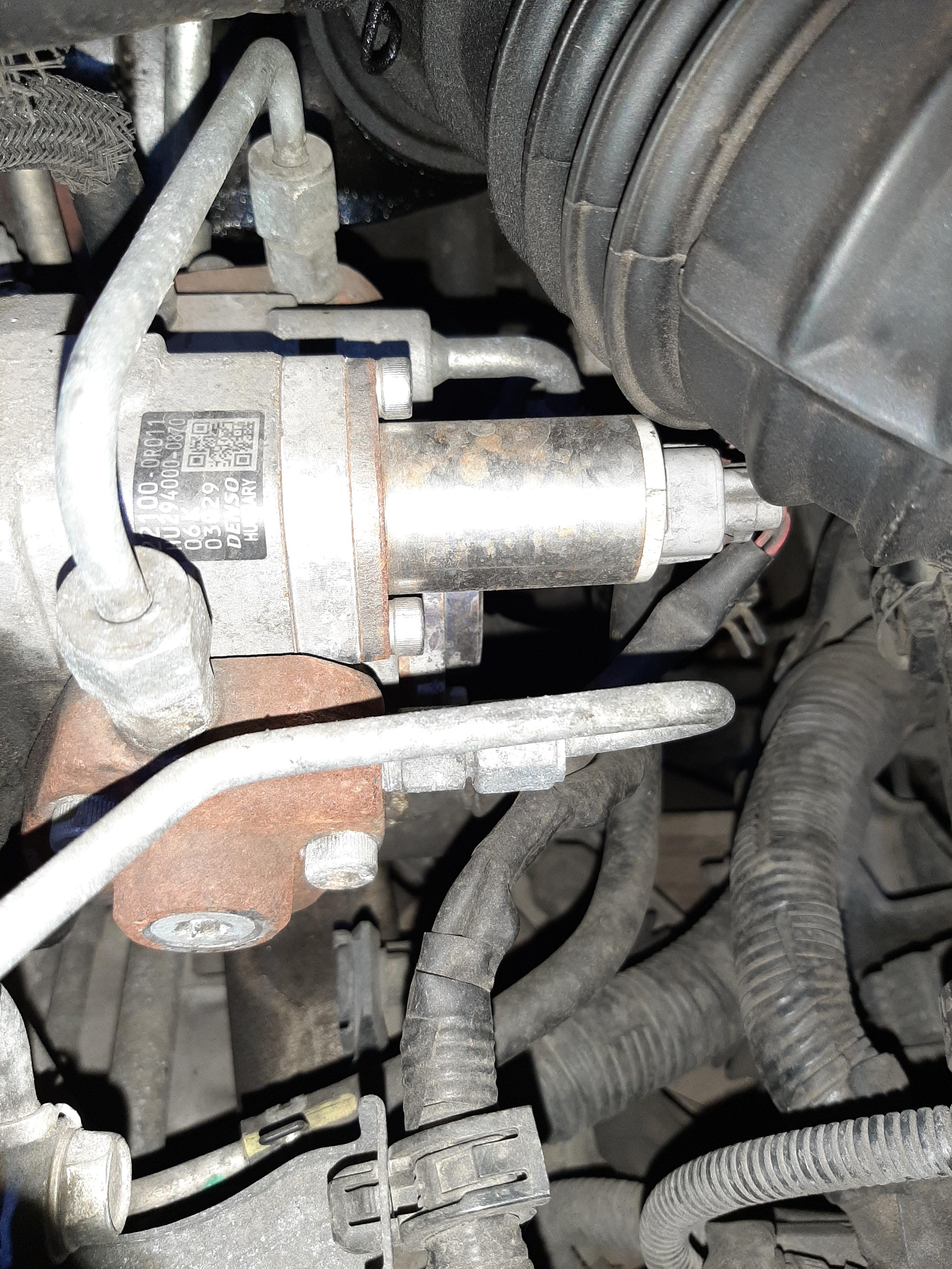

My 120k (new toyota engine at 100k) 2.0 d4d struggles to start when cold, sounds just like the glow plugs but it definitely isn't. Knocks like a good un until properly warm when it is fine. Starts on the button when warm, no error codes. Bit stuck now, all advice appreciated.
Thanks
I had a similar problem a few years ago on my 2008 ('58) D4D and it turned out to the solenoid on the end of the diesel pump (end of the Camshaft on head) that has been modified due to the internal spring not being strong enough. I'll try take a few pics next couple days and upload them so you can see what I mean and where it is. Can't remember where I bought the new unit from unfortunately but it wasn't from a dealer rather a Diesel Specialist. Obviously this cured my starting issue but may not yours but worth a possible try. 😊😊

I too would very much appreciate your your pics of the offending article.
My car runs perfectly well, smooth idle and good MPH. It's just the initial start up first thing.
