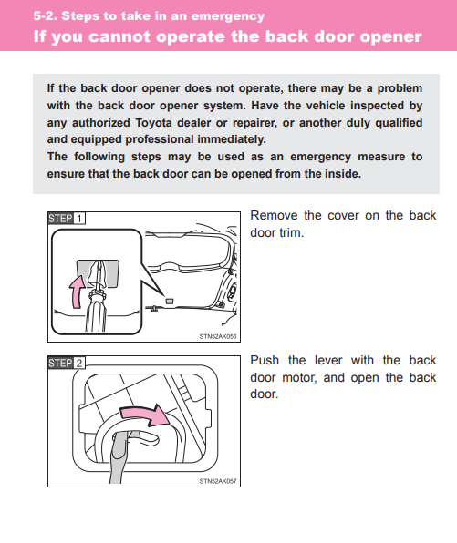

Owners manual, page 599
https://d24bc9lyrt5en5.cloudfront.net/Customer-Portal-Admin/emanuals/TOYOTA/OM64590E.pdf

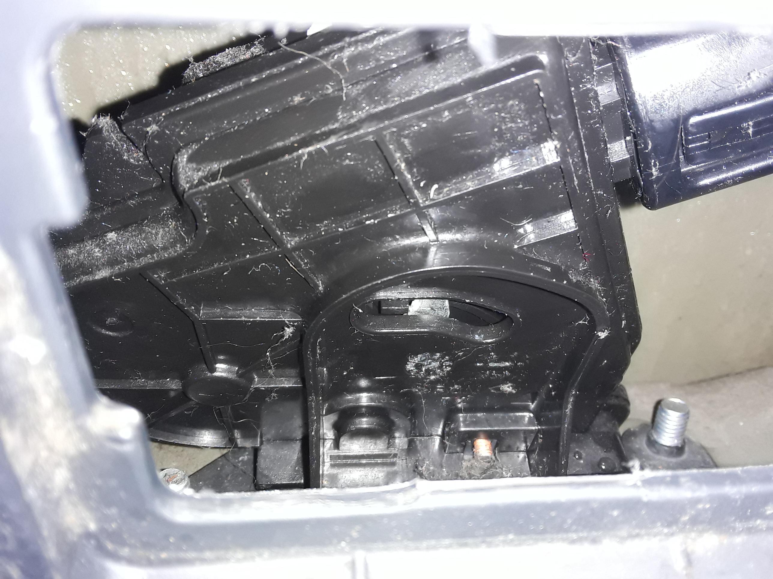

Spot on.
Small cover exactly in the diagram.
Slid open without any problem. There was some duct tape caught between in the top gap (from other work I was doing) and removed of course.
However, it seems it may be electrical as will not open again without going through the same process.
This is probably why I can't hear any open/shutting sound at the boot.
On the top there is a cover housing leads and two white multi connectors which seem to look ok but who knows.
Any micro-switches or such that would need changing?
I am just a simpleton and open for any inexpensive suggestions?

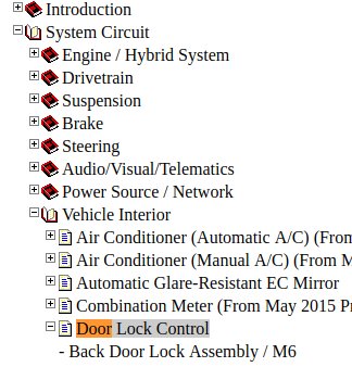

Here is the 2016 Avensis  EWD which is somehow publicly available, so we can use it as an example, so to the back door switch as shown below to see the schematics, i'm guessing it's the same.
I can't really read this that much, but TR+ going from the main body ECU should be short for Trigger +, meaning car is triggered to send + to the lock to operate it.
https://www.toyota-tech.eu/td/td3ewd/pgm/standaloneEWD.html?pubNo=EM25G4E_v1;ewd_type=top;ewd=TOP001;term=201610;vwlang=EN;ewdpath=/td3ewd
