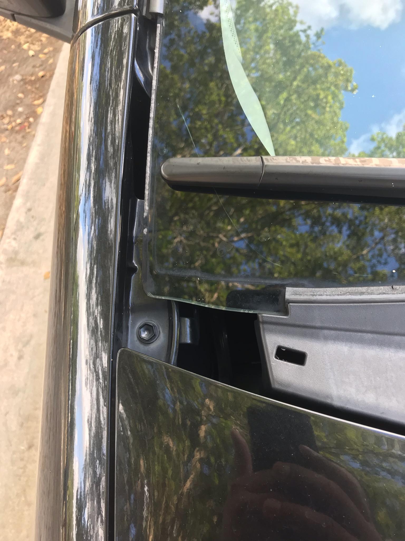

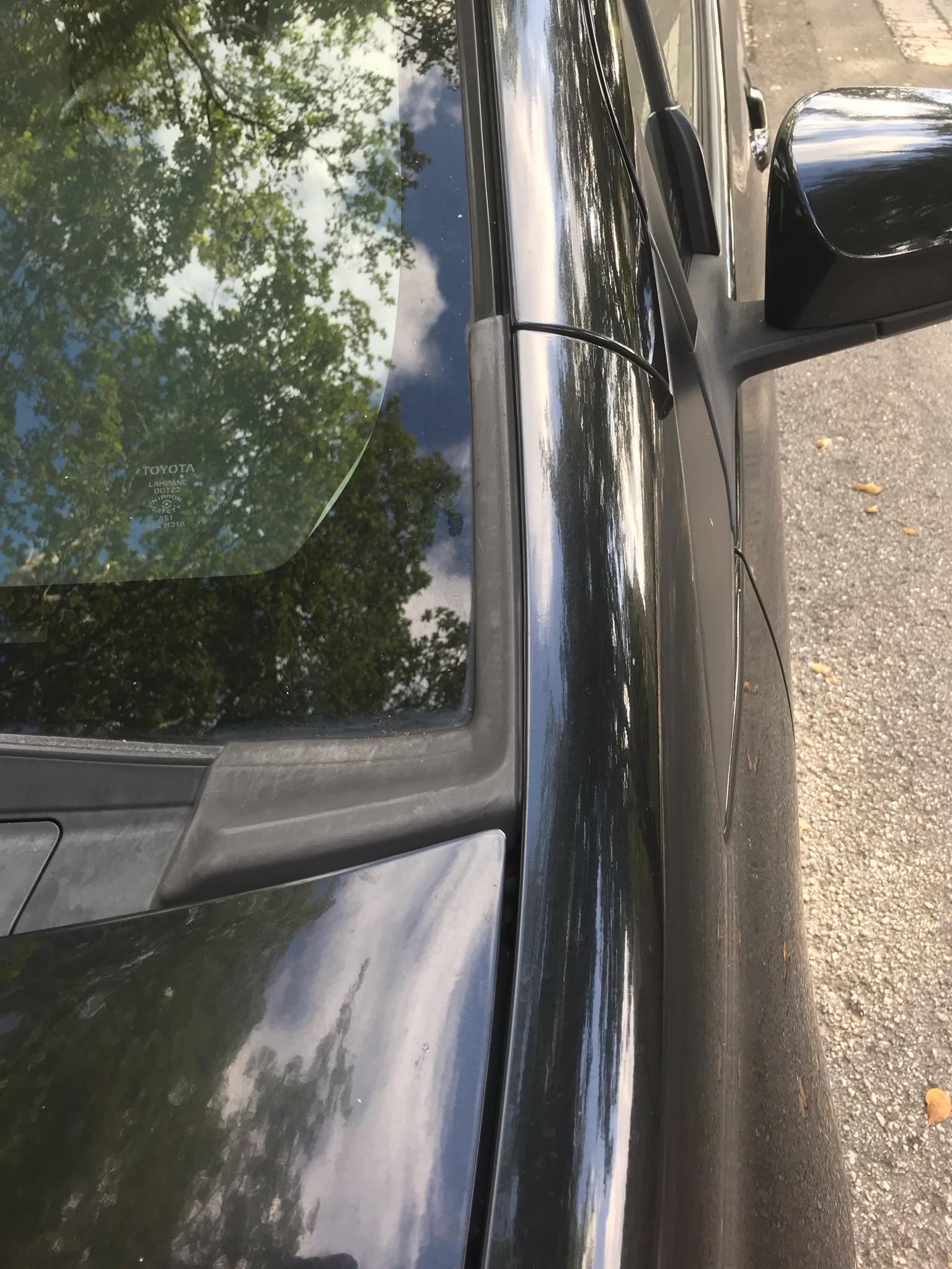

I went into my car and I notice the corner plastic was missing from the windshield.
I have been trying to look online for the part name so far I found  Cowl Extension for Toyota corolla
https://parts.toyota.com/p/Toyota__Corolla/Cowl-Extension-Right-Ventilator--Cowl-Side/62922018/5508302010.html
But its hard to tell which part is it on a Yaris 2013, I cant tell from the diagrams.
https://www.toyotaonlinepartsdepot.com/
Parts-King on this forum will help if you give him the right information ie  IN no/reg no.  He is a parts manager at a Toyota dealership.
Since you are not from the UK, if you do contact Parts-King, you should provide VIN instead, or you can go to japan-parts.eu, enter VIN, then go to Body and find the part there.
Once you locate the part, you can click on the part number and can try to inquire for a price. But i think best would be to contact local breakers (junk yards) and get a used part from them.
Anyway from a short search the part number might be  55705-0D090, but this could be wrong as i might have chosen different chassis than yours since your profile is not filled in completelly.
What county are from ? Jap or French built ?? If you PM me your Vin and i will look it up
