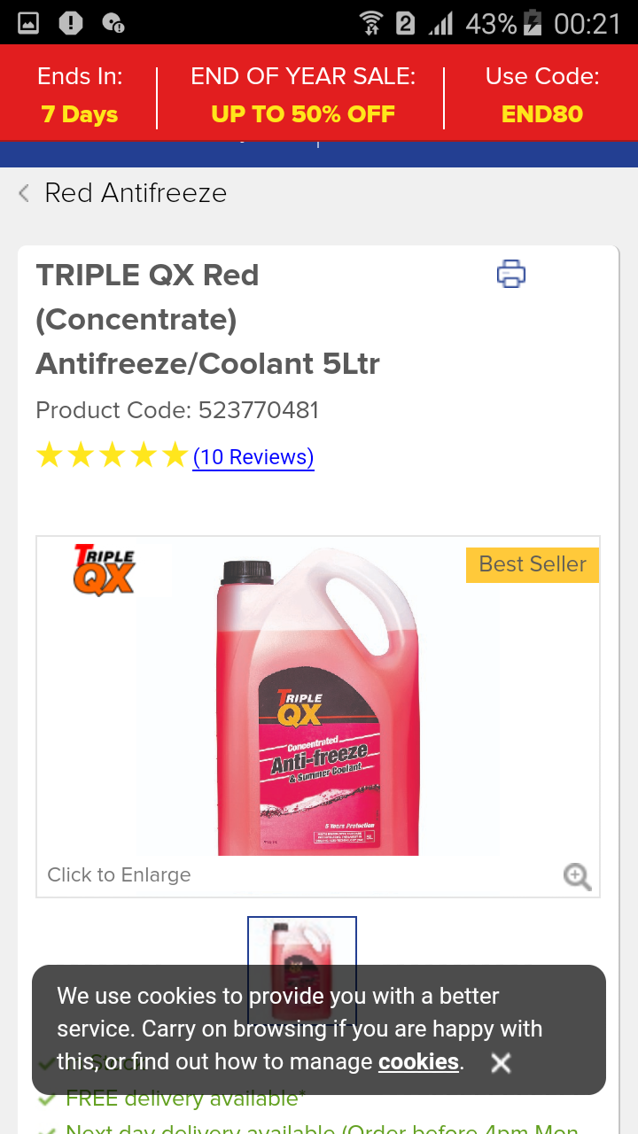

Hi, I have a Toyota Yaris 2001 1.0 litre model....I'm looking to top up the engine coolant as its virtually bone dry in the plastic tank..i think what's left of it is pink but not sure due to dirt. Would this one be suitable???...Also wondering would i flush the old stuff out with distilled water? and how i'd do this....plus how much coolant does this model of car need??...any help would be much appreciated.

Then fill it up with pink coolant ( probably you need about 4 litres).
