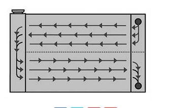

The radiator could allow a fair bit of water though as you did with a hose, but could still be partially blocked which means under the load of a long drive it cannot cool things down enough and / or the waterpump is faulty.
Assume you are seeing the temp gauge going up to hot on a long run,  but could it really be the temp sender or gauge thats actually giving the wrong info ?
Have you checked the external underside of the water pump to see of there is any signs of dried or wet coolant, indicating the seals/bearings are failing ?  Can you feel any play on its pulley or hear any bad noises ?
Think if its still got the original radiator and its been stood for a year then its likely partially blocked, plus at that age probably got a small leak as well, mine already had.
You could try back flushing the radiator , easy enough to pop out ( well on a 1.6 rolla ) and / or using a bottle of car radiator Unblocker, but always a slight risk it shows up smaller leaks ..

You could try back flushing the radiator , easy enough to pop out ( well on a 1.6 rolla ) and / or using a bottle of car radiator Unblocker, but always a slight risk it shows up smaller leaks ..000063.jpg
I’ll have a look at the radiator then I reckon. I doubt it’s the temp gauge showing the wrong info as I can physically feel the extreme heat from the overheated engine when I stop to let it cool down.
ill also have a look around the water pump too, see what I can find. appreciate all the help!
If it's been Sat for a year, I'd be inclined to do full coolant and oil flushes on principle,  for which suitable products are readily available. It's amazing how small an amount of sludge can cause problems.
Good luck!
Try some flushing solvent, looks like plenty of sludge. Who knows how old was the coolant was to begin with.
