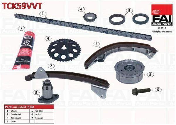

As you can see from this pic, the chain kits are quite comprehensive and a major job to fit.
