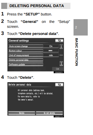

it almost worked. Monitor asking me about favourite word.  As it is imported, don't know anything about it. Any idea what can I do about that.
28 minutes ago, Mohammad rana said:
Thank you very much
Try this, it should delete the password also, it's from owners manual for the English 2012 prius, so it might not work.
Anyhow, you need a copy of the owners manual, maybe you have the japanese one, it might be there.
