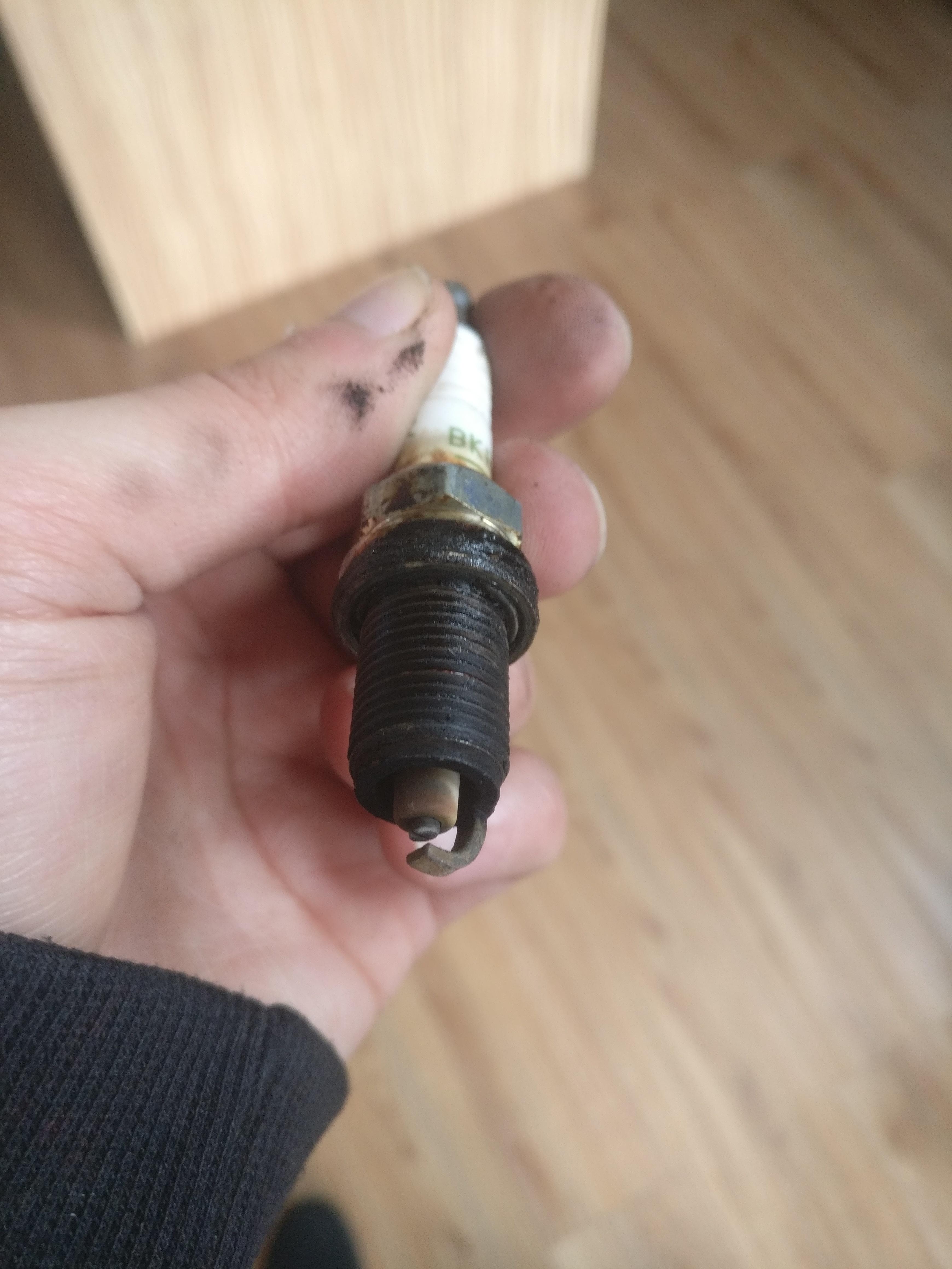

Gap looks massive.  Have you got a set of feeler gauges so you can measure the gap. Do you know what the gap should be?  The tip doesnt look a bad colour.
Its been wet, the centre electrode is fairly worn, re gap the plugs would help and a scrub with brass wire brush or hard nylon brush, if not replace them
With the amount of oil on/around that plug i would say that it needs a cam cover gasket (its just old and gone crispy)
Edit. Plug gap 1.0-1.1mm (1L and 1.3L) if its a jap built 1.0 its 0.8mm
Its been in since october 2018 and the car has been turned on a handful of times. so I think its just got muck on it and im gonna service it as soon as possible

I've never heard my fuel pump before when switching on, so may not indicate that its failed. Looking at the plug, the centre electrode looks worn, but if its cleaned up with a wire brush and gapped it should still work reasonably well. As I have said before, if you want to check fuel supply, ie the pumps pumping, disconnect the fuel pipe between pump and engine and see if you get fuel while starting the engine.
