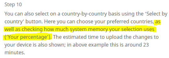

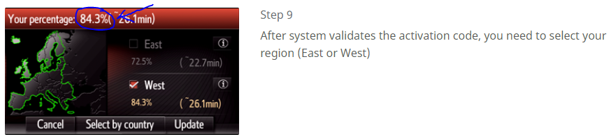

I also noticed it said my system memory percentage was 93%. Not sure if I should be concerned about that or not.
Ah right. No, that's not a concern at all as it is just the memory allocated for the NAV functionality. You would, of course, only be choosing either the Western Europe region or Eastern but if concerned, you do get the option of only loading the UK maps (further on in the dialogues) if you never drive abroad and that reduces memory usage further...
