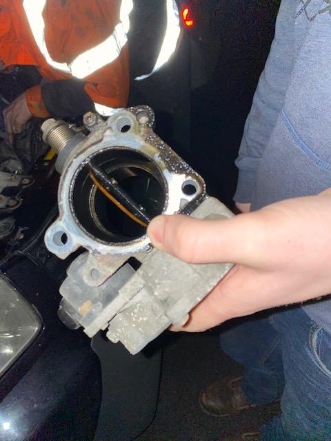

They tried unplugging one of the sensors going into the throttle body and it started to idle properly, but when it was driven it went into limp mode.
They then took off the throttle body and completely cleaned it, but its still doing the same thing.

Oh - also - we took out the EGR last night and cleaned it as the car was throwing the P0200 code and the P0403 code last night.
This didn't make a difference.
